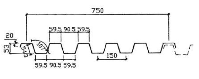

I am using these Dimensions, with 5mm thickness
I draw a polyline replicating the above image, then used walladd and set width to 5mm and height to 3m and went over the polyline to create the cladding sheet.
The part that I am not following is creating the style. Does creating style means that when I deploy walladd with the saved style I get __/---\__ instead of standard recangular wall?
