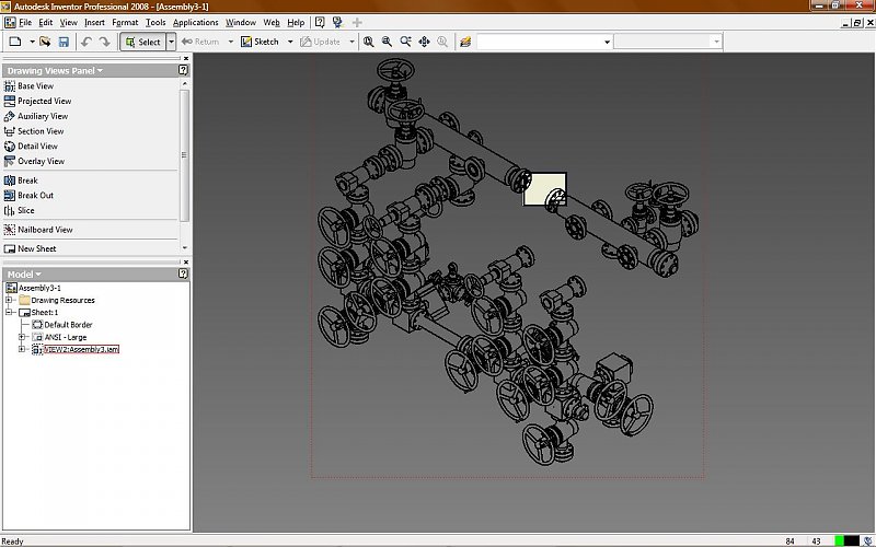

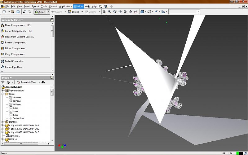

kidoy Posted November 3, 2008 Share Posted November 3, 2008 hello... pls see attach pic before reading... 1 picture show in .iam and the other is in .idw, in .iam everthing is complete aside that graphics are mumbled then on .idw some lines or even a parts are missing... i encouter this graphics problem once i work for more conflicated assembly (just i think) and when i convert this assy to idw. i lost some lines actually sometimes whole part i dont know why, is there a required setting in graphics when using AIP i mean is it something to do with display settigns under application options toolbar? i tried to manifulate the option but nothing happens, my pc graphics is 512mb.. thanks in advance... Quote Link to comment Share on other sites More sharing options...
Lazer Posted November 3, 2008 Share Posted November 3, 2008 I don't think playing with the setting will fix this problem, I would only suggest you visit the Autodesk Inventor website and list the graphics cards that are compatible. Quote Link to comment Share on other sites More sharing options...
kidoy Posted November 4, 2008 Author Share Posted November 4, 2008 thank you lazer, but im sure my pc configuration is enough to hold 1000parts and i check the specs that AIP 08 need before installation i even buy new pc for this... Quote Link to comment Share on other sites More sharing options...
Aussiemike Posted November 7, 2008 Share Posted November 7, 2008 What driver are you using for what card? Quote Link to comment Share on other sites More sharing options...
shift1313 Posted November 7, 2008 Share Posted November 7, 2008 Some ATI graphics cards have problems with cad work. What graphics card are you using. Memory isnt the only thing. I know prior to 08 ATI was still having trouble. My computer at work has an ATI grpahics card and when using solids works parts vanish all the time. Inventor hasnt produced any noticible issues on my new computer yet. At home I use Nvidia Quadro graphics card and its 1000times better!. The nvidia quadro fx series is cad specific. Quote Link to comment Share on other sites More sharing options...
