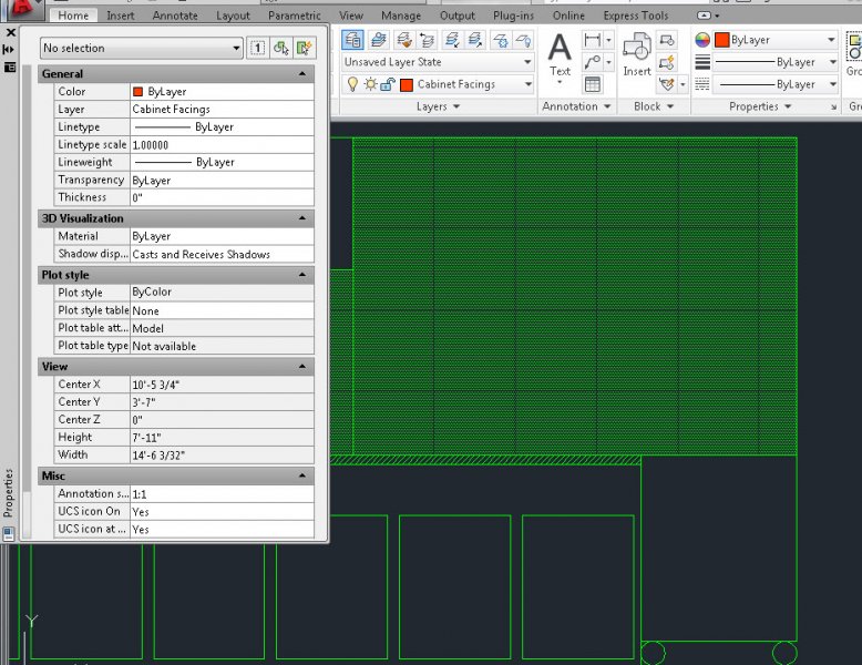

bgood2go Posted July 24, 2012 Author Posted July 24, 2012 Thanks but - yeah, would think it would be that easy but I have tried every permutation of that and layer options there are. I must have some setting enabled that is doing undesirable things to my layers.??? I select the objects and go to their properties and it shows that I have them on the correct layer....but when I am in model space and select the objects the command line indicates they are on the current active layer, which is not where I want them??? I have all layers turned on exit out of all commands and the objects are not the color of the layer I assigned them to. I am quite vexed at this point. Thoughts? Quote
f700es Posted July 24, 2012 Posted July 24, 2012 Are you drawing "by layer" by this I mean are all setting in the Properties pallet set to "by layer"? With this setting all items take the properties that you set in the layer manager when you created the layer. When that particular layer is active. Quote

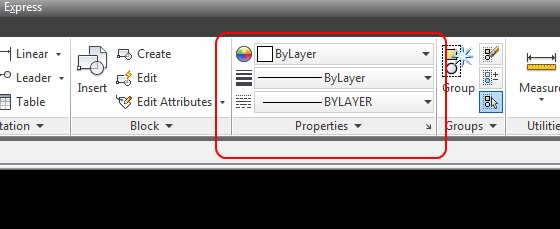

f700es Posted July 24, 2012 Posted July 24, 2012 Well I can almost read it Is that per chance a block? If so it was created on that green layer and not drawn by-layer and it will not take on the properties of the inserted layer, looks like a red colored layer. Double click on that item and see what happens. Send me the file if you want to. I'll take a look. f700esyahoocom Quote
rkent Posted July 24, 2012 Posted July 24, 2012 You have an associative array there so it acts like a block. The object may be on one layer but if you create the array on another then it will say it is on that layer while using the object from another layer. Explode the array (at least temporarily) to see the result. Quote
f700es Posted July 24, 2012 Posted July 24, 2012 Ah so it is a triangle, got to get my eyes checked. Thought it was a square Quote
bgood2go Posted July 24, 2012 Author Posted July 24, 2012 sorry about the first pic...just installed Snagit so I can get better shots......try this..... this is a rectangular array so object or block? Again newby so still figuring out who is what etc... Quote
rkent Posted July 24, 2012 Posted July 24, 2012 From 2013 help file Associative. Items are contained in a single array object, similar to a block. Quote
bgood2go Posted July 24, 2012 Author Posted July 24, 2012 rkent -- thnx-----yes - was checking it out...not a block per se but acts like one I guess....lot of reading between the lines with this program =) .....very powerful though. Thank you both for the help. I am sure you will see me whining about some other things over the next weeks... Quote
