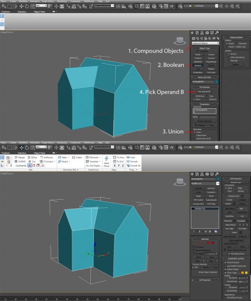

I would Boolean the 2 objects using the "Union" option.
Position the 2 objects appropriately and then click on one of them to select it
Switch to "Compound Objects"
Click "Boolean"
Select the "Union" option
Click "Select Operand B" and then click on the other object
After the 2 objects have been Unioned, Convert to Editable Poly so you can continue working.

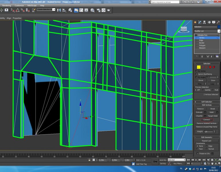

Everything went well except I still have some issues connecting vertices although they are on the same polygon afaik.
So we're not allowed to have "ngons', only polygons with 3 or 4 vertices.
Most of the polygons I was able to fix by connecting the vertices, but some give problems.
http://i50.tinypic.com/2n8obrd.jpg
4 sided polygons, (quad's), are best because they allow for objects to be smoothed evenly without any kinks. 3 sided polygons, (tri's), are ok but should really only be used in inconspicuous spots where they won't really be seen. Tri's can sometimes cause kinks and smoothing errors. Ngon's are really not a good idea. They can, and will, cause smoothing errors and problems when rendering.
You can simplify your mesh and make it all quad's by doing what I show in the image below. Green lines would be ones to keep. Delete all other lines.
