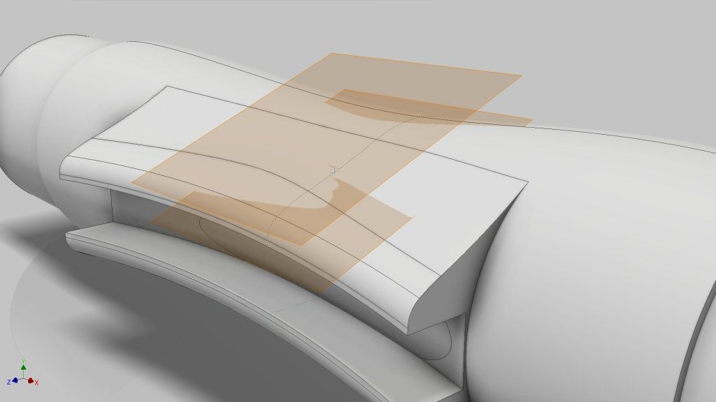

abstracted Posted July 30, 2012 Share Posted July 30, 2012 All you need to do is create a point on the tapered face. Then (with the workplane command active) click on the point, then click on the tapered face. In the image (i'm assuming I chose the right tapered face you were talking about), the top plane is just an offset of the tangent plane. You can barely see the point in the center of the bottom plane. Quote Link to comment Share on other sites More sharing options...

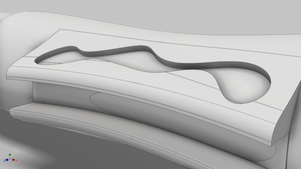

abstracted Posted July 31, 2012 Share Posted July 31, 2012 I don't know what your inlay is, but I think this is what we're looking for? The depression has a uniform depth through the entire profile. Quote Link to comment Share on other sites More sharing options...

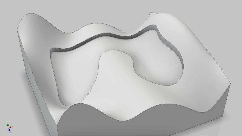

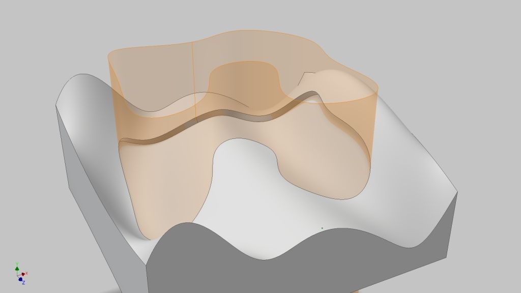

abstracted Posted July 31, 2012 Share Posted July 31, 2012 Yes, you can do this for any strangely shaped face(s). There are multiple ways to do this depending on what your working with. 1) Start by making a plane that you will sketch the inlay from, it's orientation should be as if you were going to extrude the inlay into the model. Extrude the inlay (as a surface, not as a solid) so that it intersects the face(s) that the inlay penetrates. Use the split command to split the face(s) at the intersection with the inlay extrusion. Finally use the Thicken/Offset command to indent the inlay. In the following image you can see an example of the surface I am talking about Note (if you don't already know) that going with the thicken/offset command makes the offset extend in the normal direction at the edges of your profile. You can make the edges extend in an axial direction using a different method (Difference in next image). Quote Link to comment Share on other sites More sharing options...
