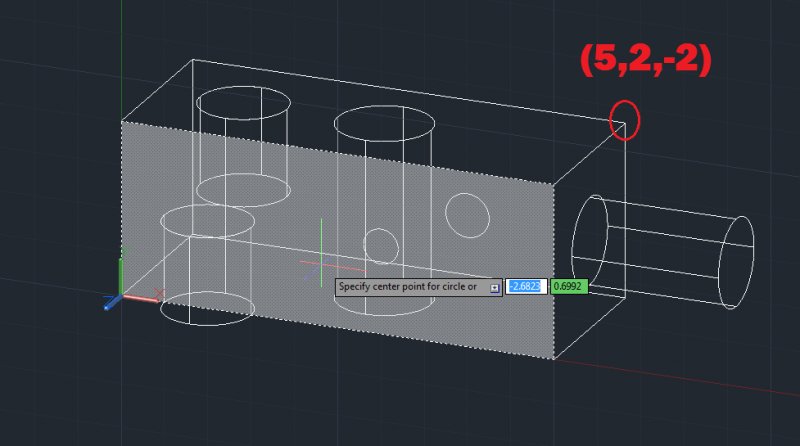

zmarcoz Posted July 29, 2012 Author Share Posted July 29, 2012 I tried to put the UCS like the attached picture and then use 'circle' command. After I put numbers into the dynamic inputs. The location goes to unknown point. I have no clue what is going on. As you can seen in the attached picture, the 'current point on the plane' is (-2.68, 0.6992). It is not reasonable because X should be positive. I have no clue what is the -2.68. Please help Note the corner point of the block is (x,y,z) = (5,2,-2) Quote Link to comment Share on other sites More sharing options...
Dadgad Posted July 29, 2012 Share Posted July 29, 2012 Set your UCSFOLLOW variable value to 1, or you can set your PERSPECTIVES by using the VIEWS toolbar, in which way you will find this all much easier. Draw your geometry on the faces of the solid using those orthogonal views from the VIEWS toolbar. When you are ready to start using the PRESSPULL command to create the holes or protuberances, choose an ISOMETRIC perspective first, also from the VIEWS toolbar. Once your geometry is laid out on the face, don't bother using direct distance entry to punch the holes, if they are meant to go all the way through your 3D solid, just select the circle on the face when prompted by the PRESSPULL command, then move it in the correct direction until it comes out the other side, and your hole will be completed. Better yet just watch this video, and you will see how easy it is. The first 3:30 seconds are about the EXTRUDE command, then the expanation of PRESSPULL starts. I hope that helps you. Having just reread your first post I see that these are Blind Holes, so go ahead and use your direct data entry, after you have indicated the direction in which you want them to go. Turn on your CENTER OSNAPS to help you layout your hole locations accurately. Quote Link to comment Share on other sites More sharing options...
zmarcoz Posted July 29, 2012 Author Share Posted July 29, 2012 Thanks Msasu and Dadgad The way I do now is turn on UCSFOLLOW as DAdgad said , then move my UCS to the corner to create my component and then use move command as Msasu said. Thanks again Quote Link to comment Share on other sites More sharing options...
