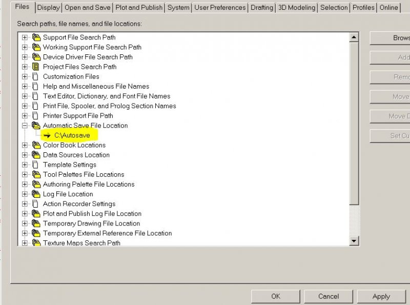

Kobbe Posted July 29, 2012 Share Posted July 29, 2012 Hello! Is there an automated backup for files that are not saved a single time? I have set automaticly backup every 5 minutes, but that seams only to work on files u have saved at least one time. Did i just lost my whole work because automatic backup system is not activated on new files that are not saved yet? Quote Link to comment Share on other sites More sharing options...
Dadgad Posted July 29, 2012 Share Posted July 29, 2012 To the best of my knowledge, that is not the case, but I could be wrong. Have you confirmed the AUTOMATIC SAVE FILE LOCATION from your OPTIONS > FILES? Check out these very useful links in nestly's post, #7 http://www.cadtutor.net/forum/showthread.php?71309-Autosave-Backup-not-working Quote Link to comment Share on other sites More sharing options...
Kobbe Posted July 29, 2012 Author Share Posted July 29, 2012 To the best of my knowledge, that is not the case, but I could be wrong.Have you confirmed the AUTOMATIC SAVE FILE LOCATION from your OPTIONS > FILES? Check out these very useful links in nestly's post, #7 http://www.cadtutor.net/forum/showthread.php?71309-Autosave-Backup-not-working Sweet! It was there! As an .ac$ file. I had not set this location or know it existed! I only new about the .bak files! Quote Link to comment Share on other sites More sharing options...
Dadgad Posted July 29, 2012 Share Posted July 29, 2012 Presumably you have already read the two links which nestly posted in that other thread? If not, I would strongly suggest that you, and everybody else do so, good information. Quote Link to comment Share on other sites More sharing options...
