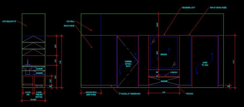

amorican Posted July 30, 2012 Posted July 30, 2012 i'm not sure 'tail' is the right term. but as you can see from the screen capture, they all suddenly disappeared on me. any idea what i might have done? you've be a life saver if you can help me! someone suggest the Multileader settings, but i dont think that applies to these leaders. the only style i have under multileader is standard, and any chages i make dont effect the leaders. it's Autocad 2011. Quote

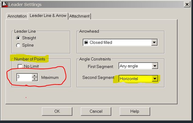

Dadgad Posted July 31, 2012 Posted July 31, 2012 Welcome to CADTutor. Enter QLEADER at the commandline, then enter S for settings, and you will see the LEADER definition dialogue box. My guess is that your maximum number of points for the leader has been set to 2, perhaps while using a lisp program which was cancelled midprocess, thus leaving your setting changed. and unrestored to your previous setting. Set it to 3 or more, and you may want your tail set to land horizontally? The multileader settings also include similar options, but as you pointed out QLEADERS are not MULTILEADERS. :wink: Quote
amorican Posted July 31, 2012 Author Posted July 31, 2012 thx dadgad. first, thanks for showing me these settings. completely forgot about them. unfortunately, they are already set the way you recommend. and when i change them (just to see what happens) nothing happens. any more ideas? Quote

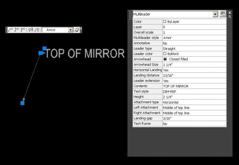

Dadgad Posted July 31, 2012 Posted July 31, 2012 It sounds to me like they may be ANNOTATIVE, which I never use. If you click on one of them, and check PROPERTIES, what does it say it is? What layer are they on? Did you create them, and know they are QLEADERS, or might they be MULTILEADERS drawn by someone else, which you assumed are QLEADERS? Quote
Dadgad Posted July 31, 2012 Posted July 31, 2012 If you just change the settings, I don't believe the way they are displayed will change, you will need to redraw them to have those changes applied. Quote
amorican Posted July 31, 2012 Author Posted July 31, 2012 annotative is set to 'no'. i dont know for sure how they were drawn. i'm thinking i copied them another drawing. the problem is, they've been fine forever....then WHAM, something happened and i can't figure out what it is. if i have to go back and draw all new leaders....well, tomorrow is gonna be a looooooong day. Quote

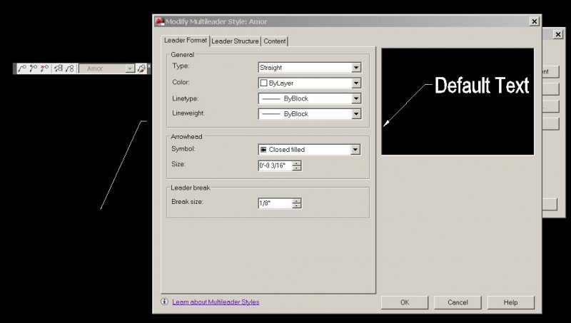

Dadgad Posted July 31, 2012 Posted July 31, 2012 The STANDARD style of MULTILEADER created the style which I suspect you are missing, which includes a predefined horizontal LANDING (tail). You can quite easily check this hypothesis by creating one, and I suspect you will agree with me. I am not sure, but since you say they previously looked differently, I still suspect that these might have been affected by possible exposure to Autocad 2013. I can't figure out how else they might have morphed into straight leaders, they don't even do that if you EXPLODE them. You can recreate them by using the standard MULTILEADER style, although you will want to make some minor modifications using the MULTILEADER STYLE MANAGER, which you can find on the end of the MULTILEADER toolbar. Quote

amorican Posted July 31, 2012 Author Posted July 31, 2012 i should have dug in before asking some of the questions above. i just set the Content to None for this case of existing text. drawing new multileaders won't take terrible long...but it's a hassle for sure. that said - holy crap, these multileaders are GREAT! Quote
Dadgad Posted July 31, 2012 Posted July 31, 2012 If you used the standard multileader style you could just leave the existing MTEXT and orient you multileaders to them on the fly, approximately. If you create a multileader style I would think you would want to include the attached MTEXT, as it is always perfectly aligned, spaced, justified, etc. The way they were the MTEXT and the LEADER were 2 distinct entities, and would move independently. With one of the MULTILEADERS, they could be a unitized entity. You could mirror one of them if you wanted, I think the MTEXT would be okay, have to check the justification after you do it. Quote
SLW210 Posted July 31, 2012 Posted July 31, 2012 Somehow the associativity was lost between the leader and text, use _QLATTACH to re-associate. Use MLEADERS unless you save back to Quote
amorican Posted July 31, 2012 Author Posted July 31, 2012 Somehow the associativity was lost between the leader and text, use _QLATTACH to re-associate. Use MLEADERS unless you save back to oh wow, well that's interesting. when i reassociate, it's still not quite right. i'd have to grab the tail and drag it back to the text. so i guess these are my options, eh? man, i sure wish i knew what blew up my drawing. Quote
