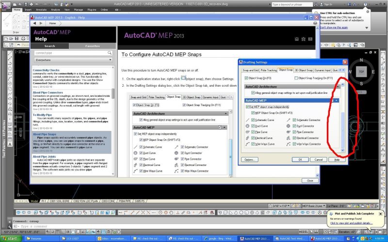

Sometimes the answer is as plain as the nodes on our face.
wow, it appears that 'node' does it after all... go figure!
Yes, the Node Object Snap will work since AEC Pipe Objects contain a Node at the ends of the pipe. However, it's best to turn off your OSNAPS and use the MEP Snaps instead. Make sure OSNAPZ isn't on either.
