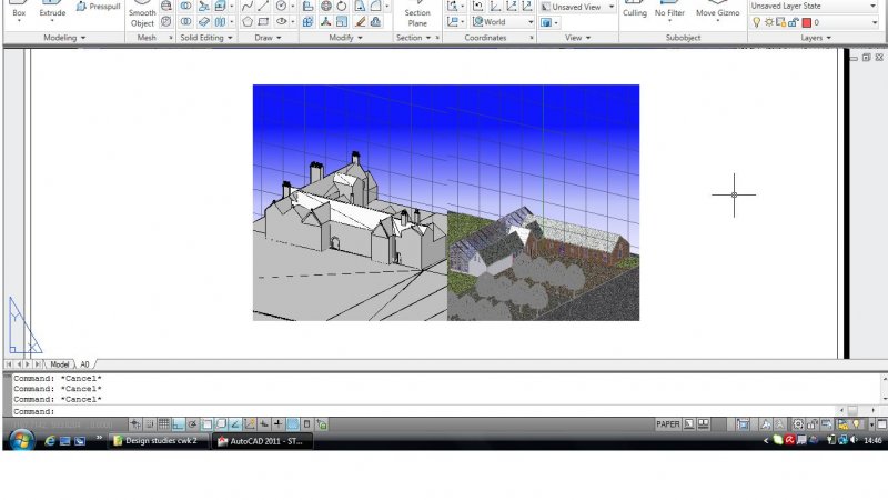

pbooth11 Posted August 5, 2012 Share Posted August 5, 2012 Hey ppl, I am wanted some help if anyone maybe able too? I want to create 2 visual styles for buildings in autocad 2011, I have the main building then a proposed extension to it! I want to show the original building in say x ray visual style n extension in realistic, does anyone know if this can work? Someone told me I could do something in paperspace using polygonal viewports, but unsure how to do this? Thanks in advance Paul Quote Link to comment Share on other sites More sharing options...

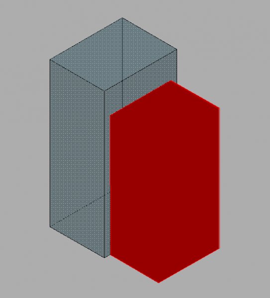

ReMark Posted August 7, 2012 Share Posted August 7, 2012 Rough example of mixed visual styles. The red object is shown in a Realistic style and the object behind it is in X-Ray style. Quote Link to comment Share on other sites More sharing options...
pbooth11 Posted August 10, 2012 Author Share Posted August 10, 2012 hi all thanks for all the advice.....i figured it all out in the end, and looks the part. cheers Quote Link to comment Share on other sites More sharing options...
ReMark Posted August 10, 2012 Share Posted August 10, 2012 Well that is good to hear. Can you share an image with us? Thanks for the update. BTW...what method did you finally use? Quote Link to comment Share on other sites More sharing options...

pbooth11 Posted August 11, 2012 Author Share Posted August 11, 2012 this is what i did, but i decided not to have insert it in my slide show, just created different views Quote Link to comment Share on other sites More sharing options...
