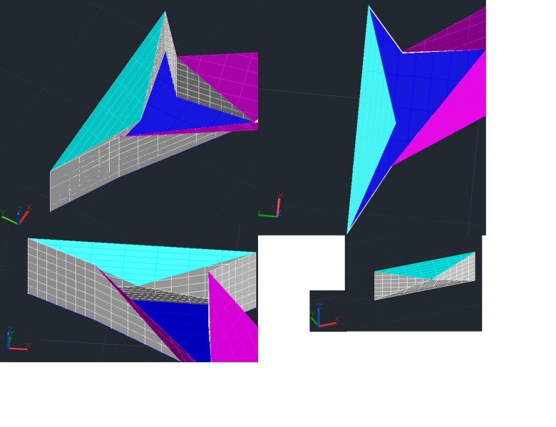

turboCAD Posted August 7, 2012 Posted August 7, 2012 Hello! I tried to slice a solid after a quite complex surface and received this error. "The Boolean operation on solid and/or surface bodies failed. Modeling Operation Error: Inconsistent face-body relationships. SLICE failed for selected solid." What I have tried: I up-scaled the surface-solid ensemble by 10x but it didn't work(same error) I extruded that complex,multi-plane surface and then sliced it with a horizontal plane and got the desired solid BUT: I would like to know what the cause of that problem was and how it can be solved so that I can slice that solid following that surface. Thank you! Quote

turboCAD Posted August 7, 2012 Author Posted August 7, 2012 ok, this is what I did: before arriving to the complex surface, I had created the simple,plane surfaces and I saved a copy at every important step of the design; so I went back, took out the surfaces that I thought were the problem, and extruded the remaining complex surface...and it worked. Now I will show you the part that was causing the problem in this printscreen: the lateral pyramids Quote
turboCAD Posted August 7, 2012 Author Posted August 7, 2012 imagine filling with water the cavity between those walls(extruding from blue surface upwards ) and then slicing along the walls that contain the water. that is what I could not do.As soon as I eliminated the pyramids(cyan color) I was able to extrude BUT I was not able to slice a solid along that surface. conclusion: I reached exactly the design I was aiming at but in a labouring fashion rather than an elegant engineering way Quote
ReMark Posted August 7, 2012 Posted August 7, 2012 We can't troubleshoot an image. Know what I mean? Quote
JD Mather Posted August 7, 2012 Posted August 7, 2012 I can't say anything from the image, but - how far are you from the origin? would the surface terminate the solid (does it pass all the way through)? Doesn't look to me like it does. Can you reproduce the same error in a simplified example that doesn't reveal any proprietary information? Why are you using surface for this design - it looks to be all planar faces in the end. My guess is that since the information should be kept proprietary you will have to hire a consultant and have them sign a non-disclosure agreement. Quote

turboCAD Posted August 8, 2012 Author Posted August 8, 2012 I am trying to extrude the red 3dpoly upwards 2 units and then slice after that surface Quote

ReMark Posted August 8, 2012 Posted August 8, 2012 2 units? That is a large distance compared to the object shown which measures 0.3 units. I'm confused as to what you want for a final shape and where exactly you plan on slicing this object. Quote
