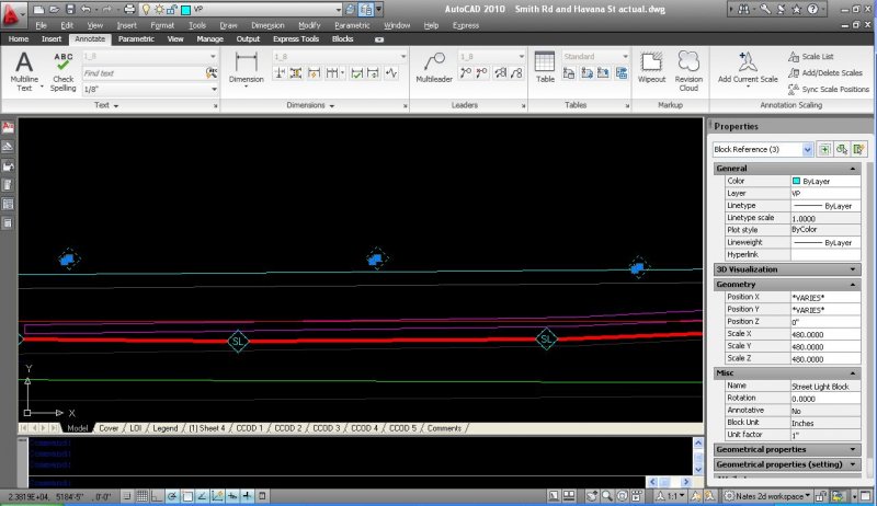

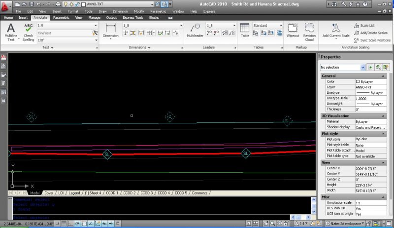

toberino Posted August 14, 2012 Author Share Posted August 14, 2012 After Select>Previous hit enter, then hit enter again......Get A Grip Below is a screenshot of three blocks individually selected with the grips showing.... Below is a screenshot with the select command invoked and the previous option selected... And then with that last enter which just ends the select command... Quote Link to comment Share on other sites More sharing options...

irneb Posted August 14, 2012 Share Posted August 14, 2012 Have you tried my suggestions in post #22? E.g. the PSelect was something which worked like the Select does now when PickAdd=2. But I think you may run into the situation as I've described later, seeing as Lee's code "could" issue a ssget which would clear any previous selection - so none of these would do what you want. If this is the case, then try one of my other suggestions: (1) use Filter instead of QSelect (makes reusing the same filter selection a 2 click process instead of multiple clicks and typing as QSelect does); or (2) save a selection set into a lisp variable so you can reuse it whenever, no matter what's happened to any sort of previous selection (add the code to a button in your CUI if you don't want to type it out / copy-paste it each time). Quote Link to comment Share on other sites More sharing options...
irneb Posted August 14, 2012 Share Posted August 14, 2012 (edited) As an example. Here's what I mean by the filter command: Or going with the lisp variable idea: Edited August 14, 2012 by irneb Wrong image for the lisp variable, sorry Quote Link to comment Share on other sites More sharing options...
toberino Posted August 14, 2012 Author Share Posted August 14, 2012 Have you tried my suggestions in post #22? E.g. the PSelect was something which worked like the Select does now when PickAdd=2. But I think you may run into the situation as I've described later, seeing as Lee's code "could" issue a ssget which would clear any previous selection - so none of these would do what you want. If this is the case, then try one of my other suggestions: (1) use Filter instead of QSelect (makes reusing the same filter selection a 2 click process instead of multiple clicks and typing as QSelect does); or (2) save a selection set into a lisp variable so you can reuse it whenever, no matter what's happened to any sort of previous selection (add the code to a button in your CUI if you don't want to type it out / copy-paste it each time). I am going to work with filter for a little bit. It is a more pwerful qselect and is transparent, which is a good feature. I just need to find a way to turn on the grips within the previous option in a command. I think it is getting the selection set properly, its just not giving me the visual that I want. Quote Link to comment Share on other sites More sharing options...
