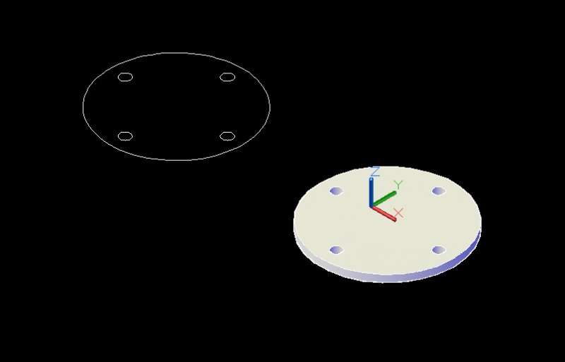

Quick example of using PRESSPULL.
Draw the baseplate for the column with the anchor bolt holes in 2D. Use the PRESSPULL command to give it height.

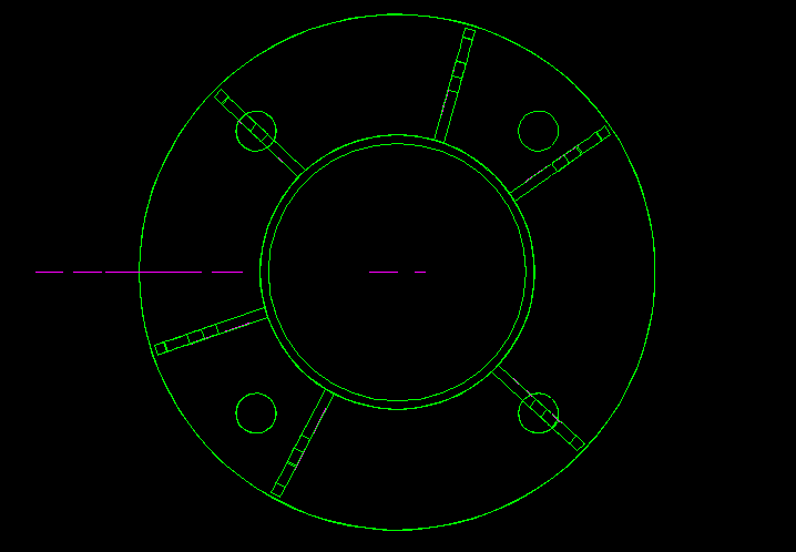

Looking at your drawing I have to ask, are the tabs located correctly on the column?
The column (green) is absolutely fine, that has already been fabricated and checked off. The rafter and the edge beam are drawn correctly. The whole drawing I posted is correct. Where the problem lies is that there are other rafters similar but with edge beams connecting at different angles. Basically I need to know how to replicate this detail but where edge beam and rafter angles differ

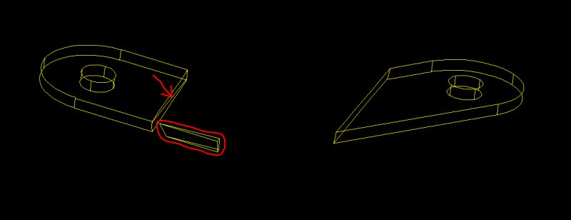

It would help if we had a drawing we could actually work with. For example. The rafter has to be exploded to get at the tabs. But it appears the tabs, which should be separate, are not. There is also a small object (circled in red) that is embedded in the rafter and there also appears to be some 'extra' geometry on the backside of one of the tabs (arrow points at it). These tabs should be independent of each other until such time as their final position is arrived at then they should be unioned to the rafter.
Are the two tabs supposed to have the same width?
After a closer look at your drawing I don't believe the tabs at the end of the rafter are parallel with the rafter itself. That will throw things off right there. I'm speaking of the portion of each tab that would be welded to the circumference of the rafter.

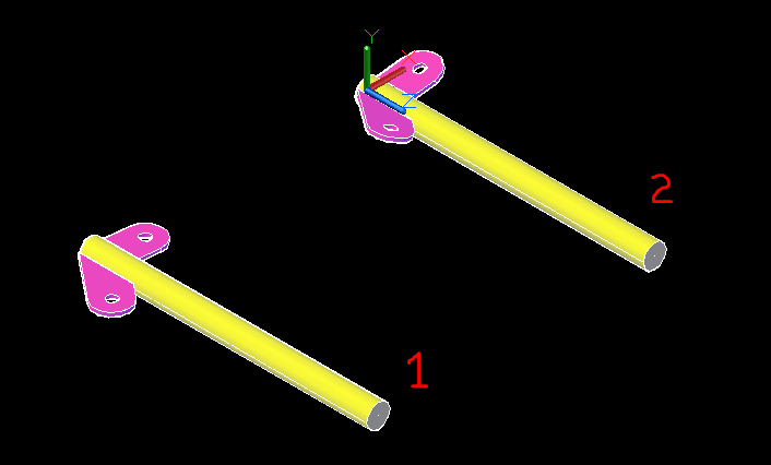

This is how I would do it.
1) Create the rafter and add the two tabs at a zero degree angle.
2) Using the end of the rafter as my center of rotation, rotate each tab to its desired angle. In my example one is rotated 15 deg counterclockwise and the other 15 deg clockwise.
Then I would attach the rafter to the post and rotate the entire assembly to the required angle.
