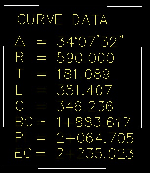

BMCD31 Posted August 13, 2012 Share Posted August 13, 2012 Hi - I'm wondering how I can add station data to my horizontal curve label style. I've tried using reference text but I'm not sure how to get it to pick the beginning/end of the curve segment. I've attached and example of what I'm looking for. I can get everything to look right except for the BC, PI and EC. Thank you! Quote Link to comment Share on other sites More sharing options...

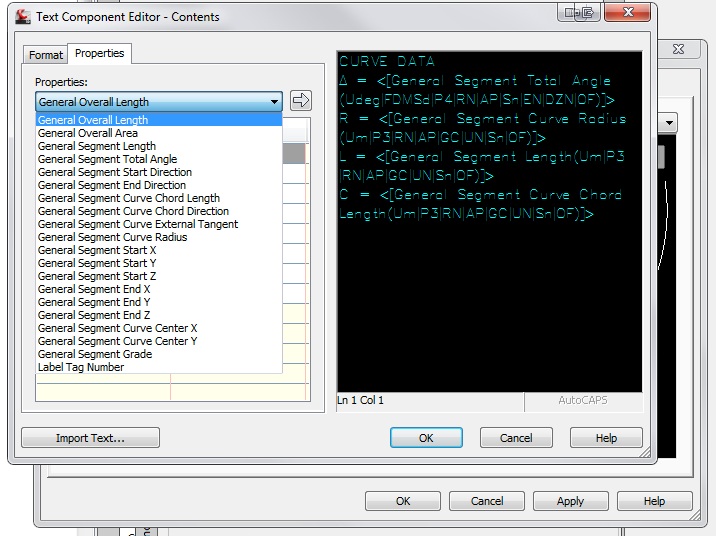

BMCD31 Posted August 13, 2012 Author Share Posted August 13, 2012 I don't have that in my list. What am I doing wrong? Here is my drop down menu. I added labels by clicking Add Label-Multiple Segment. Once labelled, I selected the curve label (which is actually called a General Segment Label) and then edited the style. In the Edit Label Style box it is called a General Curve Label....? Quote Link to comment Share on other sites More sharing options...
Bill_Myron Posted August 13, 2012 Share Posted August 13, 2012 There are two different Curve Labels. One for General Curves, and one for Alignments. Toolspace - Settings - Alignment - Label Styles - Curve That is where you would create your label. In the Add Labels dialog box, under Alignment, make sure that you have the Curve Label Style set to the Alignment Curve Label, not the General Curve Label. The Alignment Curve Label has an icon that looks like the Alignment icon, The General Label has the three wrench icon. Quote Link to comment Share on other sites More sharing options...
