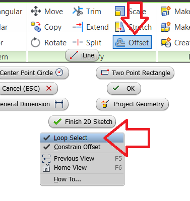

Following through an online Autodesk tutorial I can across the following
Select one of the edges, then drag it to the inside, and click to place. All edges highlight and drag. If all the edges do not highlight, right-click and make sure Loop Select and Constrain Offset are checked in the overflow menu, then retry the selection.
In the sketch and in my case, I was unable to select all the edges by just selecting one of them. However, there are no Loop Select and Constrain Offset in the context menu.
Does any one what is the overflow menu and where to check the Loop select ad Constrain Offset?
Thanks in advance.
Post screen shot or url of the Tutorial.
Are you sure it didn't say click Offset first?
Offset.png your screen will look slightly different if using a release prior to 2010.
Hi JD Mather,
Thanks for the quick response. You are right and the tutorial was right. I completely missed the step no. 2
On the ribbon, click Sketch tabac.menuaro.gifModify panelac.menuaro.gifOffset.
Many thanks to you and sorry for the trouble.
