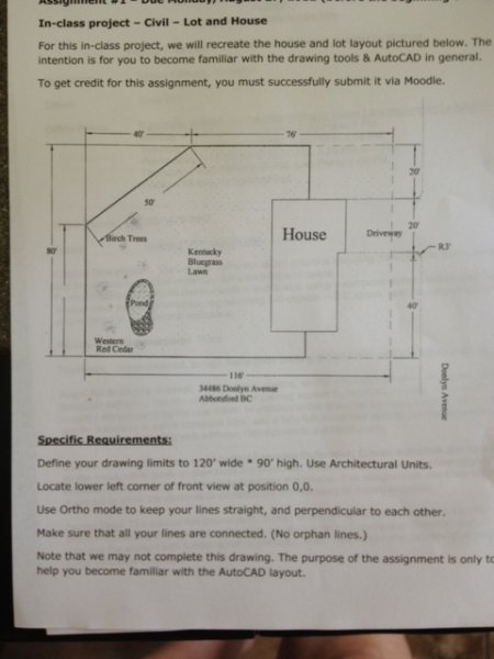

my professor in college wants me to define my drawing limits to 120' wide*90' high, how do i do that? im using autocad 2013 Lt

You can set this by typing LIMITS at the command line. Here's a link to help: http://exchange.autodesk.com/autocadlt/enu/online-help/search#WS1a9193826455f5ffa23ce210c4a30acaf-4a5b.htm

www.jpgthanks for thew feedback but is there anyway you can explain a little to where i need to start with the limit i dont understand

Type the word LIMITS at the command line then press the ENTER key. Now look at the command line. You are being asked for X,Y limits with 0'-0",0'-0" as the lower left hand coordinate. Accept the default. For the upper right hand coordinate type in 120',90' then press ENTER. This assumes you have already set your UNITS to architectural. Follow up by doing a ZOOM > ALL.

@badlander: Don't let the LIMITS confuse you. It's simply an "imaginary perimeter", if you will. The Grid in the drawing area, when turned on and these LIMITS are set, will stop at the defined LIMITS from (X,Y) 0,0 and (X,Y) 120',90'. I will reiterate, follow the LIMITS for the lesson but don't let yourself get stuck on LIMITS. :)
In your book, where it says "Locate lower left corner of front view at position 0,0" simply means the lower left corner of the lot will start at the X,Y coordinate of 0,0 - also known as the "Origin". If you start the LINE command, and before you start drawing on the screen, you can type 0,0 at the command line and it will begin the LINE at the origin of the drawing.

Why is the professor teaching it? Because it's in the book.
Looking at the page image supplied - can't be sure, but that looks like instructor generated material.
