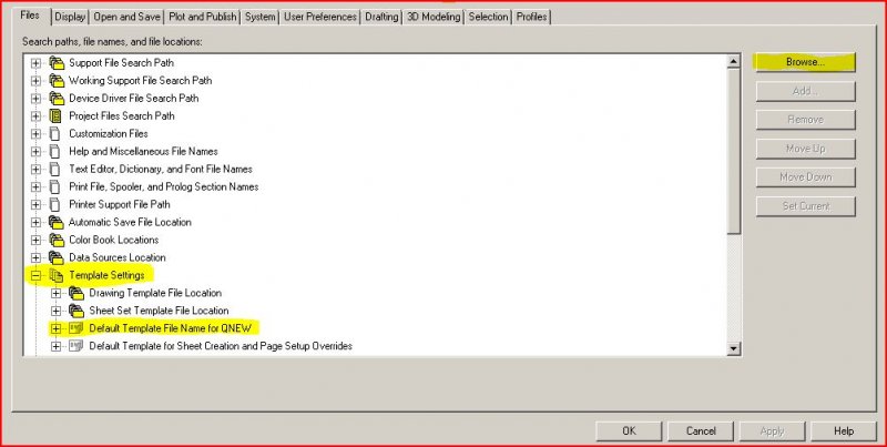

Yes, save it as a .dwt file, and give it a name you will remember.
You can also set this to be your default QNEW template, in OPTIONS.
Uhu! Thanks man! Now i hope everything goes right!
If i get some issue, I come back here. Thanks again! :notworthy:
Happy to help. :)
Set your template like this.
Use the BROWSE button to access your template dialogue box, where you can choose the new one you created.
So that in the future if you click on the NEW drawing icon, this template will be selected for you.
You can access OPTIONS by right clicking in your commandline.
Later you will add lots of other things to this template, but this is a good start. :thumbsup:
