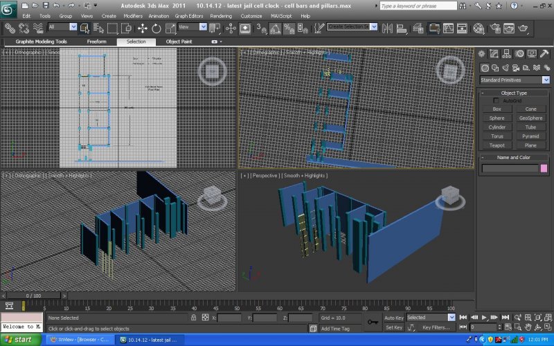

Cad64 Posted October 17, 2012 Share Posted October 17, 2012 No, make the jail cell full size. Lighting in Studio Max is based on real world units, according to your units set up, so you never want to scale down your models because the lighting won't work correctly. Just select the blueprint and scale it up. It's like I keep telling you. Use the Transform tools to Move, Scale and Rotate objects into position. Or, just use the blueprint as reference. You don't have to build directly on top of it. If the blueprint doesn't have dimensions on it, then just approximate the distances between pillars. It doesn't have to be exact, it just needs to look good. Quote Link to comment Share on other sites More sharing options...
AlienBZ Posted October 17, 2012 Author Share Posted October 17, 2012 Ok, I just got done scaling my blueprint up. But I can only see the middle portion of it, there's no way to move it up/down, L/R when its scaled up. And the pillars get scaled up with the blueprint even though I only scaled up the blueprint - what do I do now? Quote Link to comment Share on other sites More sharing options...

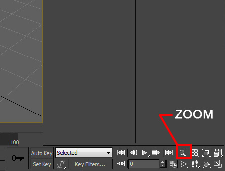

Cad64 Posted October 18, 2012 Share Posted October 18, 2012 You need to zoom out. Roll your scroll wheel to zoom in and out. This is a pretty fundamentally basic function, no matter what program you're using. Or use the zoom tool in the lower right corner of your screen. Zoom out so you can see more of the scene in your viewport. I have no idea why your pillars are scaling up when you scale your blueprint. They must be attached somehow. Quote Link to comment Share on other sites More sharing options...

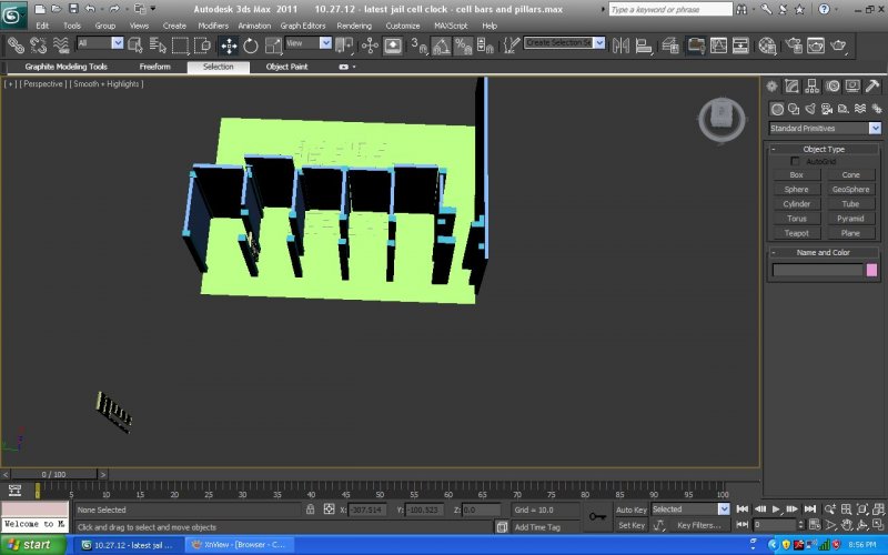

AlienBZ Posted October 27, 2012 Author Share Posted October 27, 2012 Ok, here's my latest work on the jail. But why does my model look so tall and narrow? I tried to create all the structures (walls/pillars/cell bars) according to the described units count in the Philly book tut. And part of the model is looking a bit off-center (part of it sticking beyond the "floor grid" in the Lower Right viewport) - Either I'll have to keep practicing, practicing, practicing, or there's a neat trick to get everything scaled (in L-R viewport) perfectly and "balanced" on the floor grid? Quote Link to comment Share on other sites More sharing options...

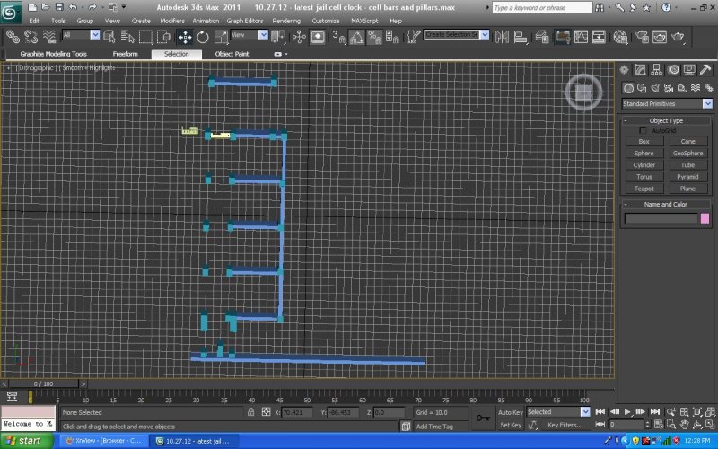

AlienBZ Posted October 27, 2012 Author Share Posted October 27, 2012 (edited) Ok, I tried scaling/moving the problemetic pillars/walls so that they match up evenly (no gaps between then - or old "evil Debbie-hulk" could figure out a way to escape and we'd rather not have that happen. ) But seriously, I find out that scaling these walls/moving them involved a lot of guess work to make sure there are no gaps between these structures? check out my screenshot, please? EDIT - now going to see if I can add a floor to this whole layout. When is the model ready to apply the "skin" (textures) to all structures? This jail cell block model will make a good scene for a DVD movie that I'm planning sometime in the future that's about the "old evil Debbie-hulk" getting arrested, court trial, jail, etc. EDIT 4 - Found out how to resize the cell block walls/pillars by clicking "modifier" then going into "parameters" and changing them accordingly, but when one individual structure is changed, all the others change with it and some individual structures are not marching up exactly with the first wall/pillar where I changed its "hieght" parameter, they all move as a group. This model was built from an earlier model I started before the model of the cell bars with the "skin" (textures), lock and hinges on it and this earlier model I never grouped its objects, but while initially building this model I cloned each wall and pillar as an instance, or I'd create a new pillar/wall. how do I get all walls/pillars to match up evenly with the door hieght? But for now I'll look in my Max Bible to try to find the solution to the problem, but if I get stuck I'll ask for help. EDIT 5 - Ok, I need help, please, I checked my Max Bible, used the "select all" command, but when I tried to go to Group > Ungroup, Ungroup was grayed out even though everything was selected, although the Group command was not grayed out. Now I'm really stuck - how to I ungroup (or fix) these structures (back to Edit 4 question)? EDIT 3 - from the blueprint (floor plan) of my jail cell block, I was thinking about (and google-researching) the dimensions of a modern jail cell in a regular state prison, the wiki said they're 6 x 8 feet, and I think that, looking at my jail from the top viewport, this is about the dimensions of the individual cells in my jail cell block - might I be correct about this? EDIT - Floor addition to jail model successful - look: Edited October 28, 2012 by AlienBZ Quote Link to comment Share on other sites More sharing options...

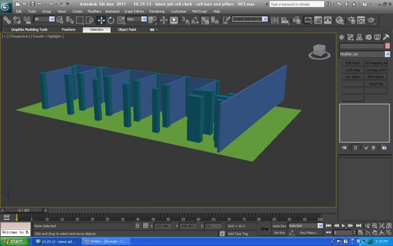

AlienBZ Posted October 29, 2012 Author Share Posted October 29, 2012 So you got it all figured out then? Sort of. To fix these uneven pillars/walls I'll just have to delete all cloned instances of them, then clone them as copies instead of instances (haven't done this yet, just figured it out last nite in bed) since I think I discovered accidentally yesterday that a cloned instance of an object behaves in lockstep with the original object (such as changing parameters) but a cloned copy of an object behaves independently of other objects - am I right about this? Quote Link to comment Share on other sites More sharing options...
Cad64 Posted October 29, 2012 Share Posted October 29, 2012 Yes, that is correct. From the 3ds Max help files: Depending on the method used to create them, cloned objects are called copies, instances, or references. Copy method: Creates a completely separate clone from the original. Modifying one has no effect on the other. Instance method: Creates a completely interchangeable clone of the original. Modifying an instanced object is the same as modifying the original. Reference method: Creates a clone dependent on the original up to the point when the object is cloned. Changing parameters for modifiers that were applied to the object before the object was referenced, will change both objects. However, a new modifier can be applied to one of the reference objects, and it will affect only the object to which it is applied. Quote Link to comment Share on other sites More sharing options...
AlienBZ Posted October 29, 2012 Author Share Posted October 29, 2012 I was right about what I figured out last nite, so I fixed my jail model, but I messed up the entry door bars in the process (so have to go back to that book from Philly to recreate another door). But anyway I think I'm ready to apply the skin (textures) to all structures then add the doors (with their hinges, locks & skin) after I apply the skin to the walls, pillars and floor. What do you think, Cad64? See screenshot: Quote Link to comment Share on other sites More sharing options...

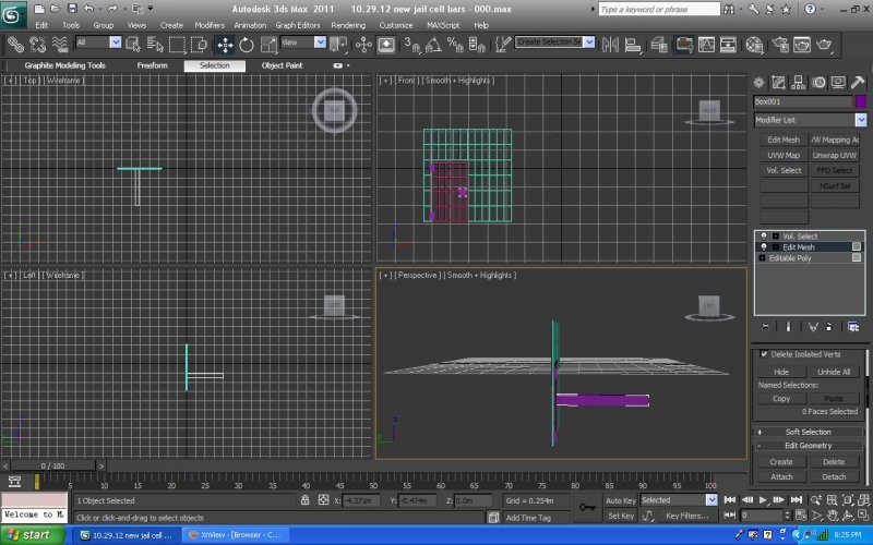

Cad64 Posted October 30, 2012 Share Posted October 30, 2012 Just out of curiosity, why do you have an "Edit Mesh" and a "Vol. Select" modifier on and Editable Poly object? Quote Link to comment Share on other sites More sharing options...
AlienBZ Posted October 30, 2012 Author Share Posted October 30, 2012 Just out of curiosity, why do you have an "Edit Mesh" and a "Vol. Select" modifier on and Editable Poly object? B/c I was trying to fix the lock. Incidentally I was thinking just now about that since this is going to be in my movie, that I should add the jail cell furniture (lavatory fixtures, a shelf for books above the bunk, a metal slab for the bunk (single bunk) chains to support bunk, and a thin, 2-inch thick slab for the mattress and a pillow (all made of leather, of course with sheet/pillowcase on them) b/c I'm thinking of having in this jail scene movie when the "old Debbie-hulk" is sentenced to jail, she's put in the cell (with bare leather mattress/pillow) the "old Debbie" is carrying the jail-regulation sheets/pillowcase and the scene sort of shows her making the bed while a demon (sort of the devil's helper) beams in next to her and the demon torments her, but she, faking self-control in an attempt to win her freedom in the (false) hopes of her family taking her back home, remains silent as she cries crocodile tears (jail bird establishment scene) - since this is a space prison, some of the other prisoners/guards are aliens (mix of humans/aliens, males/females) so how would I create all these structures (these characters, incl. the "old Debbie" will be added later) lavatory fixtures, bunk, mattress, chains, etc? Quote Link to comment Share on other sites More sharing options...
