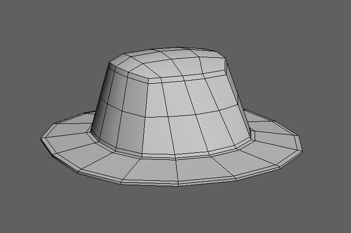

Can you post a larger image of the hat you're starting with? It's difficult to see in that first image. And turn on edged faces so I can see the topology and edge flow of the beanie.

Here, I just quickly made this one and it only took about 1 minute to do it.

What tools did you use to create that hat?
I started with a simple box, converted to editable poly and deleted the bottom polygon
Next, I switched to "Border" selection mode, selected the open border left by the deleted polygon and used the "Scale" tool with "Shift" held down to create the brim
Then I applied a "Shell" modifier to give the hat some thickness
Once all that was done I used the "Swift Loop" tool to add in more edge loops
Then I switched to "Vertex" selection mode and used the "Move" and "Scale" tools to shape the hat
