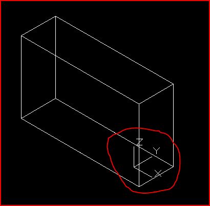

In the attached image, which is displayed in an ISOMETRIC perspective you can see the UCS icon indicating the relative directions of the different axii.
The intersection point indicates the origin's orientation relative to the UCS, and the letter describing the axis is placed in the POSITIVE direction from the origin.
