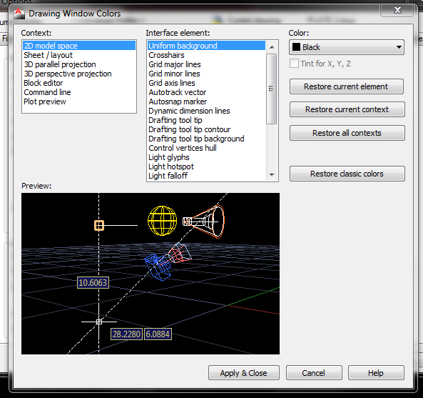

I right clicked on the modelspace backgound, went to Options, and by default, the DISPLAY tab is shown. However, things have changed since I last used Acad.
On the Display screen, there is a "Color" button, which when selected, brings up a prompt where you can select different elements, and change their color. Well, since I couldn't find any way to turn the grid off, I simply selected the horizontal and vertical grid lines and changed their respective colors to white, as the background by default is already white.
However, SOMETIMES, I want to work with a Black background, but when I change the background to black, now the grid lines are WHITE...:x arrrggrrrrrrrrr.. So now, I have to change the grid lines as well. PITA. There is a "Return defaults" selection..but that still requires changing things one by one again next time.

Modelspace is modelspace You can set whatever background color you want for modelspace.
Paperspace layout is paperspace. You can set whatever sheet color you want for your layout.
You have viewports in paperspace. These do not change the sheet color to modelspace.
Options > Display > Colors.

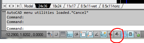

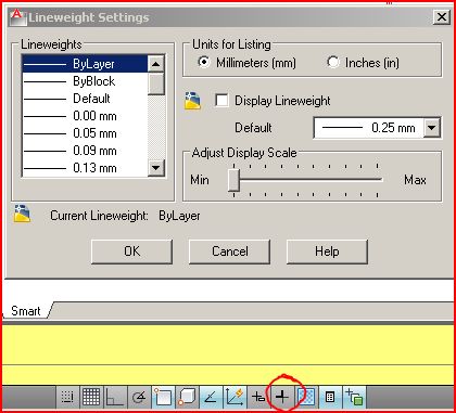

I suggest that you set your LINEWEIGHTS by layer, and turn off the LINEWEIGHT display while you are working on your drawing.
The icon where you can choose to SHOW or HIDE lineweight display is circled in red in the image.
By right clicking on the icon you can access the LINETYPES DIALOG shown here.

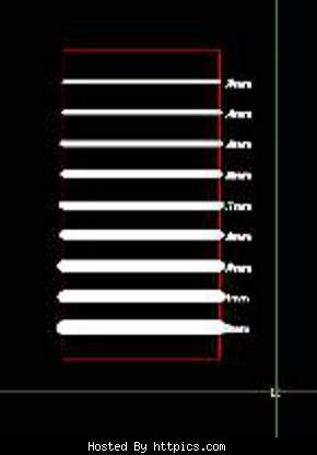

Ok, I was going to start a new thread, but since you already delved into it..let me ask you this then. Back when I was using Acad2000, I had my own little bag of tricks that I used daily to expidite my particular way of working. Right or wrong, to my way of thinking it worked. One of those "tricks" was a set of blocks I had drawn to make various "match properties" really easy for the type things I was drawing.
One of these blocks was simply a "box" with a column of lines, each of which had been modified to match some of the various lineweights in the lineweight selection menu. Originally, I had drawn this to learn how the various lineweights displayed on the monitor vs as they plotted. Even then, it was the only way I could learn how the system really worked...by doing. ha No different now...so I drew one yesterday. But something is wierd.

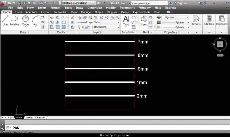

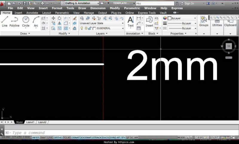

Heres what's happening. When you have an entity in Modelspace on the screen, as you ZOOM OUT, normally, the entity image gets smaller, no? Well check this out.
Here is a screen shot, Zoomed in on the last line with a lineweight of 2mm.

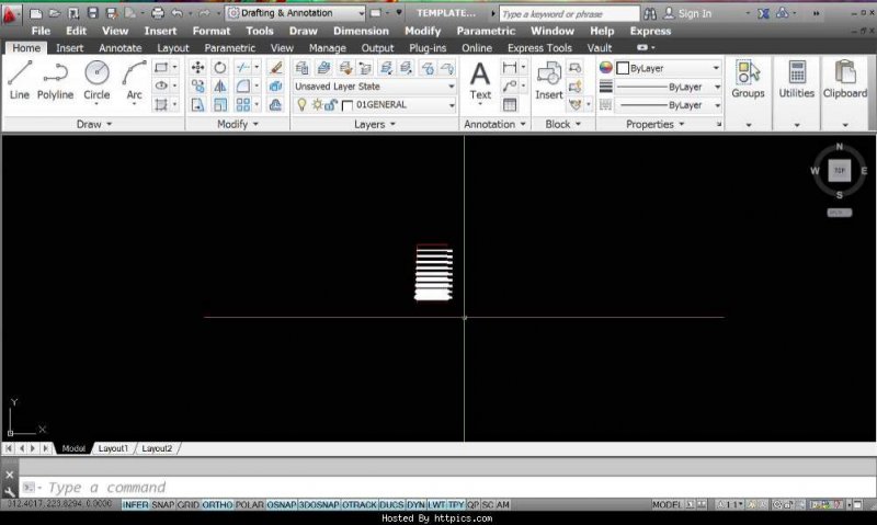

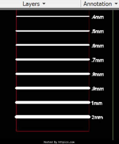

Here is a screen shot Zoomed OUT to "50"(how ever this "real time" ratio works, I haven't got a clue?). Now the 2mm "line", instead of getting smaller in width..actually INCREASE in width?????
Now, I Zoom OUT to "25" and here is a screenshot. See the relationship of the lineweight REAL image width, in comparison to the Text next to it. Compare this one to the first one. WTF?? As I zoom out..the lineweight "appears" to get thicker er...or is that wider.

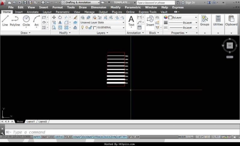

Zoom out to "12", and now it starts to really show up
Now, here I Zoom out to "1", and now you can really see what I mean.

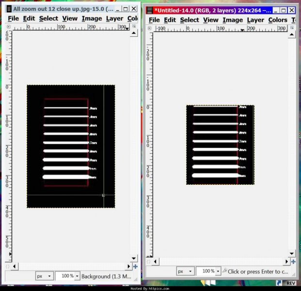

Now, I cropped and enlarged each of these in an image editor, to the same scale. Tell me what you see?
and here's the final Zoom out, close up.
and here is the first and last in comparison.
Guess what..the linewidths "appear" to be the same. W T F? I don't get it. Can someone tell me what the heck is going on?
