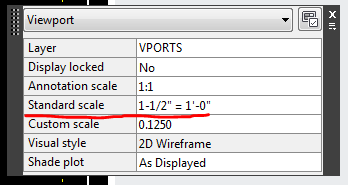

There are several ways a user can set the scale of a paper space layout viewport.
Properties palette.
Quick Properties.
From the Taskbar. You'll find this in the lower right-hand corner of your screen.
Via the Viewport Toolbar.
Or manually using the Zoom > Scale > nXP option at the Command line. This method requires the user to enter a scale factor.
