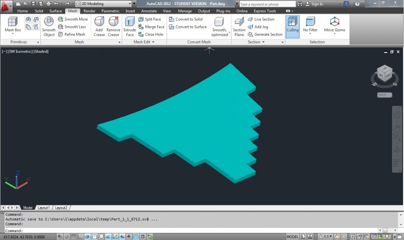

hfs Posted August 30, 2012 Posted August 30, 2012 Hello! I have a 3D geometry in .dwg format ... it is a part of an umbrella membrane structure (see the attached pic.) This geometry is divided into litte pieces. Each piece is a '3D surface' object I need to give this umbrella a thickness! I tried Extrude command; Error! the surface object should be planner I tried surface offset command as explained here http://autocadinsider.autodesk.com/my_weblog/2010/12/offsetting-surfaces-in-autocad-2011.html did not work cuz my object is not a planner surface nor a extruded surface so... what to do experts?! Thanks a lot in advance! Quote

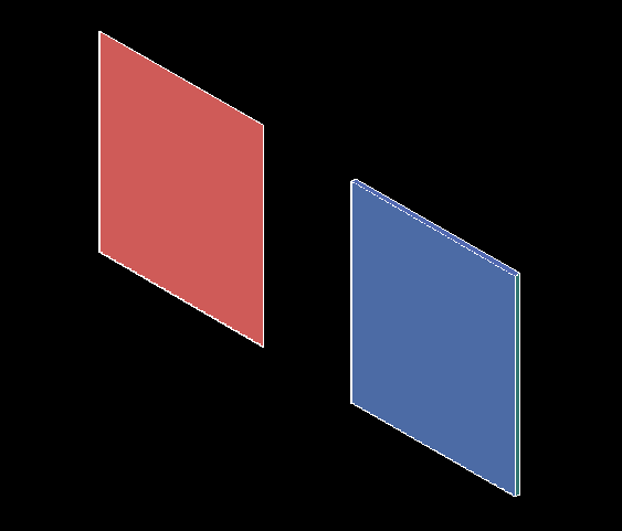

ReMark Posted August 30, 2012 Posted August 30, 2012 Surface before using THICKEN command on left. After using THICKEN command on right (now it is a solid). Quote
hfs Posted August 30, 2012 Author Posted August 30, 2012 Did you try the THICKEN command? Thanks! I will try it! Quote
hfs Posted August 30, 2012 Author Posted August 30, 2012 [ATTACH=CONFIG]36865[/ATTACH]Surface before using THICKEN command on left. After using THICKEN command on right (now it is a solid). Perfectttttttttttt! Quote

hfs Posted August 30, 2012 Author Posted August 30, 2012 I'll assume that ^ ^ ^ means you are pleased with the results. Good. What I meant by perfectttttt is that I liked your photo I tried it now It worked with a LOFTED Surface (that you can create with LOFT command) Unfortunatly, Did not work with my surfaces they are of type 3D surfaces Thanks for your tip anyway ... waiting for more Quote
hfs Posted August 30, 2012 Author Posted August 30, 2012 Here are some of those objects [Check the attachment] Part.dwg Quote

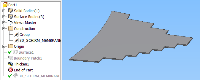

Dadgad Posted August 31, 2012 Posted August 31, 2012 The object which you supplied in the drawing is a whole bunch of contiguous 3D Faces. I am way out of my element working with Surfaces, Meshes & Nurbs, but as far as I know the 3D Faces in Autocad are always attached to a 3D Solid, and I am not aware of any way to work with those which have become disenfranchised, if you will. Like ReMark I had no luck with it, but I was sufficiently jacked up on fresh hot coffee, that I am unable to blame my lack of success on something less than CRITICAL CAFFEINE MASS. One would imagine that the program capable of this sort of work, could also export a more Autocad friendly representation. Maybe INVENTOR could handle the entity type? Quote

ReMark Posted August 31, 2012 Posted August 31, 2012 I tried exploding one of the faces but that failed since it is non-planar. I also tried recreating the shape of one of the faces uses a 3dpolyline, which did work, but it can't be extruded (non-planar) and when I make a copy slightly above it and try to loft it that doesn't work either. The thicken command obviously doesn't work because it is not a surface. One must be carefully with the use of terminology as it can lead to misconceptions about the nature of the object one wishes to edit. Quote
