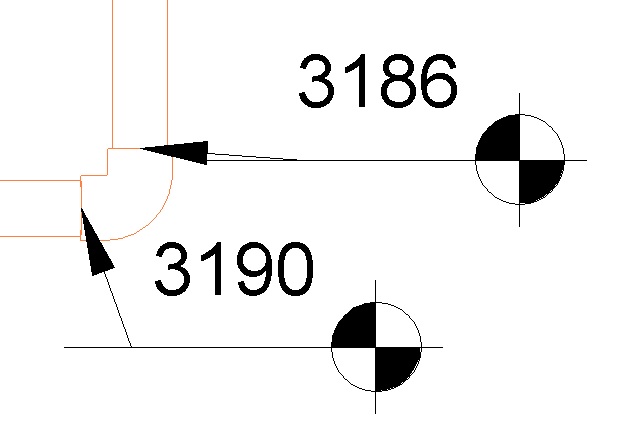

KathleenMEP Posted September 13, 2012 Author Posted September 13, 2012 Is there a way to tag the height at a pipe fitting? I have a pipe to tag that due to the services around it, needs to go in a sort of S shape. I was hoping to tag the height at each bend. I set up a tag using the label "offsetheight" but when I tag the fitting I just get a question mark. I have tried using the spot elevation on the pipe and can get the centre of the sloping pipe (thanks Lee Roy) but the fitting height would be ideal. Quote
RobDraw Posted September 13, 2012 Posted September 13, 2012 Will the height at the end of the pipe give you the height of the fitting? Quote
KathleenMEP Posted September 13, 2012 Author Posted September 13, 2012 If I put a spot elevation at the end of each pipe going into the fitting I'm getting different heights. One I've just tried for example gave me 3186mm going in then 3190mm coming out the other side of the bend. So the pipe fitting height should 3188mm I'm guessing. I don't know if there's way to set up a forumla to work that out and show that in the tag? Quote
KathleenMEP Posted September 13, 2012 Author Posted September 13, 2012 Not sure I was very clear there so I've attached an image. Quote
RobDraw Posted September 13, 2012 Posted September 13, 2012 I get the same thing. You could make a tag that will pick up the comment and manually enter the elevation in the comment for the parts. Lee may have a better solution when he comes around. Quote
