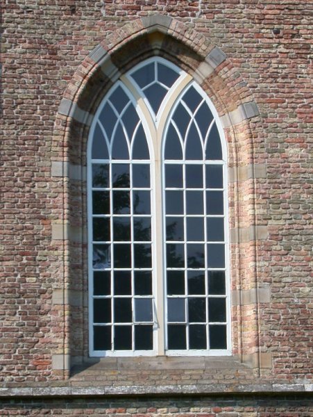

David Bethel Posted September 5, 2012 Posted September 5, 2012 Does anyone know if there are any 'standard' angles / swing points / formulas to form cathedral style windows simlar to this? Thanks! -David Quote

ReMark Posted September 5, 2012 Posted September 5, 2012 David: The terminology is "window tracery" and the style pictured in your image is called Intersecting Tracery. The link below will hopefully give you the guidance you are looking for. http://www.discoverstwulframs.org.uk/window-tracery/intersecting-tracery.aspx Quote

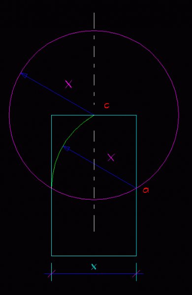

David Bethel Posted September 6, 2012 Author Posted September 6, 2012 Ah Ha! Start with the overall window size ( cyan ) Draw the circle ( magenta ), centered at middle of the top member ( c ) , radius ( x ) Swing arcs ( green ) from the intersection of the circle and outline, radius ( x ) ( Thanks! -David Quote

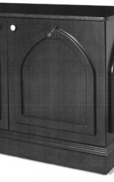

David Bethel Posted September 6, 2012 Author Posted September 6, 2012 LOL! It's a good bit different. It's a wood trim that I'm reproducing from a clients photo. It is just the shape reminded me of the windows. -David Quote
