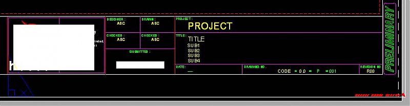

mattieg Posted November 5, 2008 Share Posted November 5, 2008 How would I go about finding a professional to critique my title block? Is there a way to post it here? Thanks in advance! -- Matt Quote Link to comment Share on other sites More sharing options...

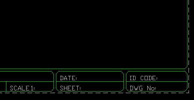

mattieg Posted November 5, 2008 Author Share Posted November 5, 2008 Actually, I guess I can upload it. Here it is, I changed the file extension to *.dwg because it won't let you upload *.dwt files. Thank you for critiqing it! I would appreciate many different opinions, so please don't hesitate to comment, regardless of how harsh it may be! -- Matt acad-a-title.dwg Quote Link to comment Share on other sites More sharing options...
hotrodz0321 Posted November 5, 2008 Share Posted November 5, 2008 it serves its purpose....i modified yours just to show you what you could do to add aesthetic values to the title block...i modified the corners a bit....just be creative Quote Link to comment Share on other sites More sharing options...
dbroada Posted November 5, 2008 Share Posted November 5, 2008 looking at hotrodz post I would change the font for standard style to simplex (or ariel) eather than txt Quote Link to comment Share on other sites More sharing options...
ReMark Posted November 5, 2008 Share Posted November 5, 2008 Given the spacing after your text have you actually left enough room for the required information without squeezing it to fit? Quote Link to comment Share on other sites More sharing options...
mattieg Posted November 5, 2008 Author Share Posted November 5, 2008 I made my template from a tutorial in an AutoCAD Tutorial Book I bummed from a Professor at College, so, I personally don't have any need for a drawing code or revisions or whatnot for my class projects. So, for scale, date, and etc, I do have enough space Quote Link to comment Share on other sites More sharing options...
mattieg Posted November 5, 2008 Author Share Posted November 5, 2008 it serves its purpose....i modified yours just to show you what you could do to add aesthetic values to the title block...i modified the corners a bit....just be creative Looks great! Do you mind if I adopt that in my template? Quote Link to comment Share on other sites More sharing options...
cpriedel Posted November 5, 2008 Share Posted November 5, 2008 I would also look into what Information is Important and emphasis. I wouldnt do e.g. "Dr. By", "Ch. By" (I would suggest to use "Drawn" and "Checked") in the same text size than lets say the Sheet Titel or No. You may also want to add a Scale and northing in the TB and maybe a space for the Arch Stamp. Not sure what this TB is meant for. Just thinking out loud Quote Link to comment Share on other sites More sharing options...
nocturne00 Posted November 6, 2008 Share Posted November 6, 2008 One important thing, Revision numbers, always include a space for those. Try to google some title blocks on the net, just as related literature to improve your own title block. Cheers Quote Link to comment Share on other sites More sharing options...
nocturne00 Posted November 6, 2008 Share Posted November 6, 2008 Here's a TB ive just completed recently. all basic info is placed, based on many tb's ive looked on the net We've just deducted and narrowed down all necessary info to these. revision descriptions are to the other side of this image. Hope this helps. Quote Link to comment Share on other sites More sharing options...
hotrodz0321 Posted November 6, 2008 Share Posted November 6, 2008 Looks great! Do you mind if I adopt that in my template? yes you may...thats why i posted it.. Quote Link to comment Share on other sites More sharing options...
