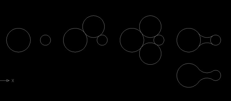

That "S shape' as you refer to it can be created using the CIRCLE command and the TTR (tan, tan, radius) option. Need a hint?
ReMark I would love a hint pls. I'm running out of hair to pull out....
The Circle command using the TTR option, Mirror and the Trim command is all it takes.

ReMark, this isn't really an accurate representation of what I'm trying to duplicate. In my example the circles that I'm trying to "marry" with the "S" curve are one circle half inside the other. (top pic is what I need to re-create and bottom is what I have so far)
I tried the TTR but I can't get it to work ..... it asks for a radius and I have no idea what it would be.

In your left view the large circle should actually be an ellipse. The long axis is 6 units long, and the short axis is 4 units long.

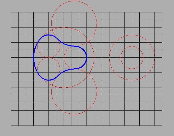

It's always nice to give us ALL the particulars when you are presenting a problem. We'll adjust our answers to suit.
WOW!! Thank you Eldon! This thread can now be closed.
