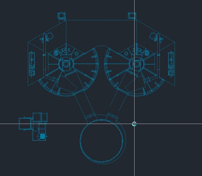

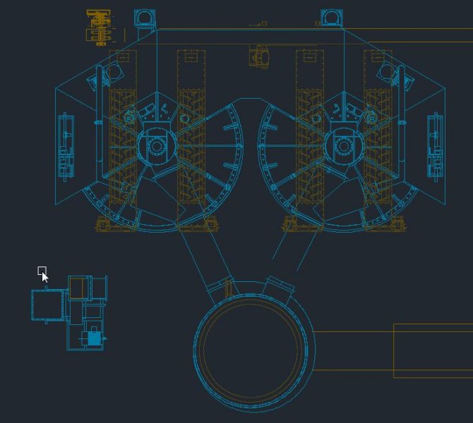

Enigma Posted September 25, 2012 Share Posted September 25, 2012 Does anyone else have an issue with isolating a layer (any layer other than one that contains a hidden line type), and then having the hidden layer appear behind it when attempting to initiate a command? Attached is an example. The first image shows my drawing with object layer isolated. But as soon as I enter some type of editing command (move, rotate, etc), in this case copy, my hidden layer appears (see second image). In my LAYISO settings, I have it set to lock and fade, but it does not lock unless I manually set my hidden layer to lock in the layer co[ATTACH=CONFIG]37450[/ATTACH][ATTACH=CONFIG]37451[/ATTACH]mmand. Quote Link to comment Share on other sites More sharing options...

Enigma Posted September 28, 2012 Author Share Posted September 28, 2012 You mised the point. Yes I could use the off option, but it's another step I'd prefer not to do when that is what the layer isolation command is suppose to, eliminate those extra steps of turning layers off. Quote Link to comment Share on other sites More sharing options...

Enigma Posted September 28, 2012 Author Share Posted September 28, 2012 That option doesn't work either, hidden layer still appears. Quote Link to comment Share on other sites More sharing options...
SLW210 Posted October 1, 2012 Share Posted October 1, 2012 Enigma, Please read the CODE POSTING GUIDELINES and edit your post. Layiso works fine on my AutoCAD 2011. Are these blocks? Can you post the drawing? Quote Link to comment Share on other sites More sharing options...
