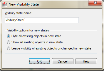

When you create a new VisibilityState, you have 3 options:
Make sure the first option is active, give a name, OK, OK and you are back in block editor. Add objects as you want. Repeat for every new VisState.

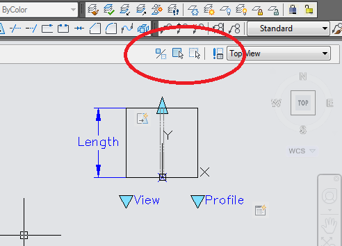

Even if you select any other option, you can still change the visibility of any object. Just play with the options available on buttons next to VisibilityState (Visibility mode, Make Visible, Make Invisible).
