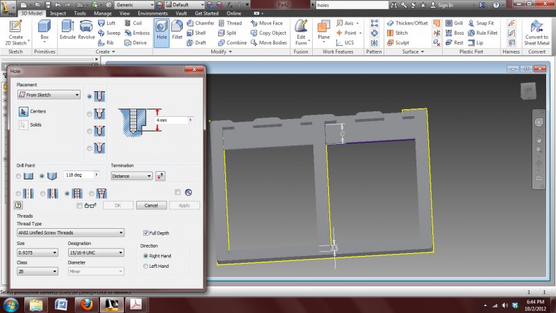

knattagh Posted October 2, 2012 Author Posted October 2, 2012 Thank you all so much for your posts I recently got Autodesk inventor 2013 student version and now I have rebuilt my object and am trying to put threaded holes in it. Although, the ok button is greyed out. Some other people have had this problem too and they have solved it via forums but I do not understand what they mean. Could you please tell me how I can get the button to not be greyed out. Thanks again Quote
JD Mather Posted October 3, 2012 Posted October 3, 2012 Attach your ipt file here. Attach screen shot of this dialog with a greyed out OK button (does the dialog box have a name?). Quote
knattagh Posted October 3, 2012 Author Posted October 3, 2012 (edited) I have attached them here. This is much appreciated. Attach your ipt file here.Attach screen shot of this dialog with a greyed out OK button (does the dialog box have a name?). [ATTACH]37606 Here is the file [/ATTACH] slide base.ipt Edited October 3, 2012 by knattagh Quote
knattagh Posted October 3, 2012 Author Posted October 3, 2012 In response to your question: Yes the dialogue box with the greyed button is called "hole" Quote

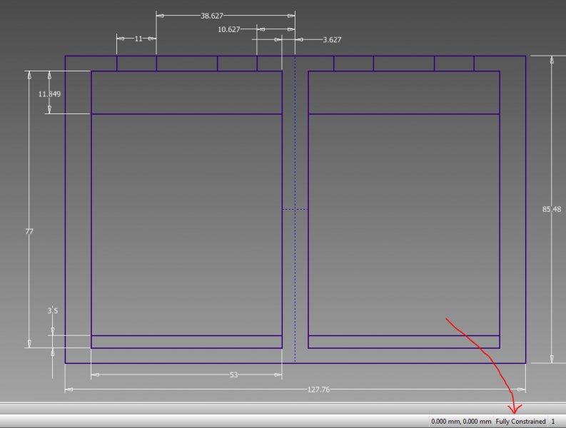

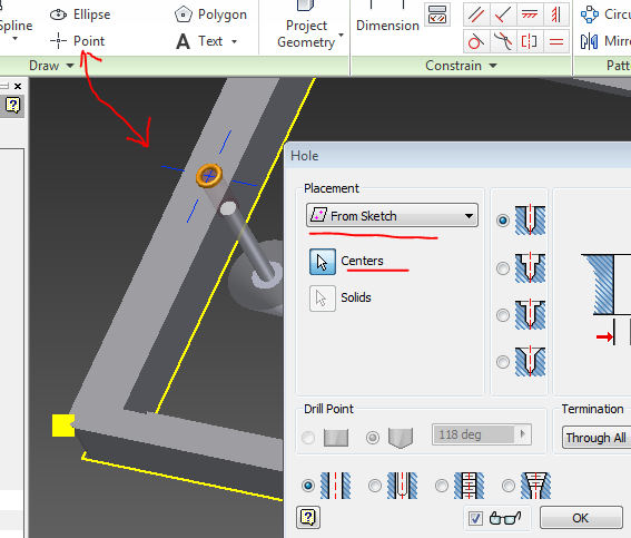

JD Mather Posted October 3, 2012 Posted October 3, 2012 You do not have any Sketch Points in your sketch for Inventor to Placement From Sketch. (I enlarged centermark point in image). Also your Sketch1 is not constrained and it would make sense for the origin to be in the center of the part since the part is symmetrical. I recommend you read this http://home.pct.edu/~jmather/SkillsUSA%20University.pdf Quote
JD Mather Posted October 3, 2012 Posted October 3, 2012 (Almost) never repeat dimensions - use geometry constraints like equal (=) instead. Quote
JD Mather Posted October 3, 2012 Posted October 3, 2012 The entire Sketch1 can be fully constrained with far fewer dimensions - this makes editing much easier. Quote

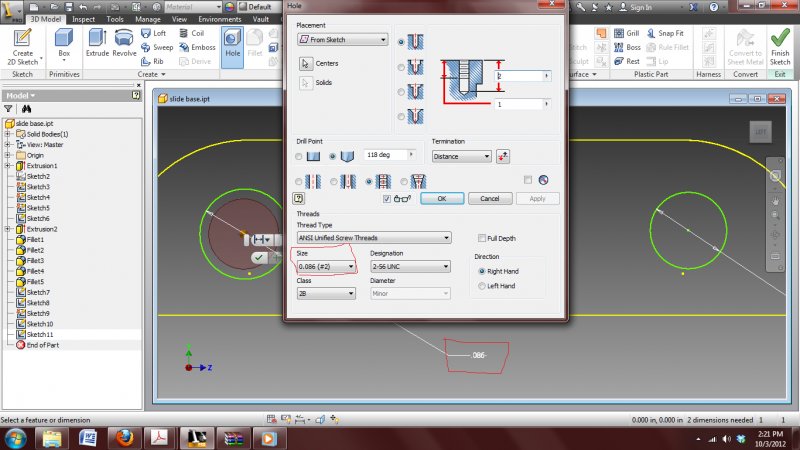

knattagh Posted October 3, 2012 Author Posted October 3, 2012 Wow thank you so much sir. If I may ask 1 more question: I have made a whole of 0.086in and sketched a circle of 0.086 inch but as you can see in the image i attached they do not seem to match. Should I ignore this? I had assumed the problem lied in the fact that screws have major and minor diameters but 0.086 is the major diameter so it still does not make sense to me. Also, The link you sent me for skillsUSA and learning how to do constraints does not work. But, if the link is about how to do constraints I can just scour the web and I am sure to find it. Thanks again so much!! Quote

knattagh Posted October 3, 2012 Author Posted October 3, 2012 This is the image that shows the difference in hole sizes Quote
JD Mather Posted October 3, 2012 Posted October 3, 2012 When you use the threaded Hole command - it gives you the correct size hole - the tap drill sized hole (but I would never ever use a #2 thread - that is eyeglasses hinge small) the machinist will hate you. But if that is what you need... If you the hole the same size as the fastener there would be no material for the thread helix - the fastener would simpy fall into the hole. This is a common mistake that beginners make (not using tap-drill size for threaded holes). This is absolutely one mistake you don't want to make when you get out into the real world. It will take months if not years or forever to get credibility back if you make theaded holes too big for the threads. Quote
