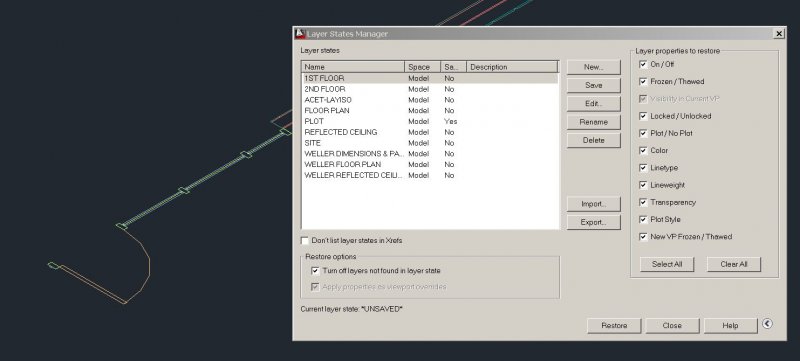

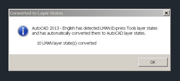

I did notice this however, which may well be causing your issues ...

Dadgad (nice tuning by the way), I am not sure what the "Converted to Layer States" is saying.

I am not really sure what it means either, but I found it noteworthy, figured I should mention it.
