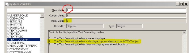

Are you specifically interested in this, as it pertains to editing MTEXT?
If so, then look at the other image, and set your MTEXTTOOLBAR variable to 1, so that your mtext editor will display while using the ribbon (the default value is 2).
