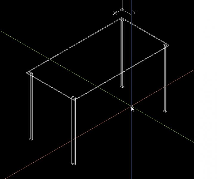

Can be done various ways using constraints, Dynamic blocks but the obvious a front end which asks questions or just break it down into a series of lisps with some smarts thrown in.
Bench L x W x T, Corner legs LxWxH std offsets y/n, internal legs y/n, Splash back L R F B all ? Height, lower support pick left & right Height above.
Make a start
: draws bench type 1
(setq pt1 (getpoint "\n Pick Starting Point"))
(setq L (getreal "\nEnter length"))
(setq W (getreal "\nEnter Width"))
... some polar stuff
(command "rectang" Pt2 Pt3)

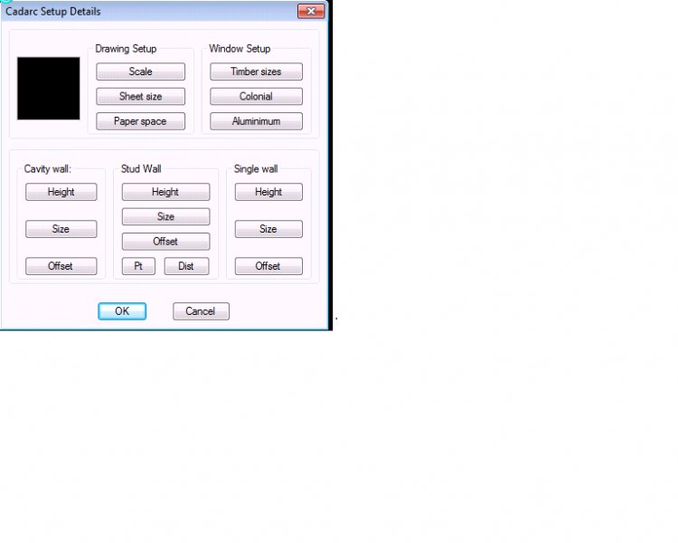

Had a bit of time next time though will be billing hours there is a number of people on this site that offer services for hire to do programs Lee-mac ? I may be interested also. The part that costs the money for what you want is the user friendly front end user error checking. I think this is a pretty good start if you want to run with it. Its just a courtesy to let others know on the forum where the post is up to.
: draw plain bench with legs
; by Alan H Oct 2012
(setq pi2 (/  pi 2.0)) ; 90 degrees
(setq Pt1 (getpoint "\npick lower left corner point"))
(setq W (getreal "\nEnter width"))
(setq thick (- 0.0 (getreal "\nEnter bench thickness")))
(setq pt2 (polar pt1 0.0 L))
(setq pt3 (polar pt2 pi2 W))
; do stuff here like layers for now just draw
(command "rectang" pt1 pt3)
(command "extrude" "L" "" thick)
(setq OF1 (getreal "\nEnter Offset from length for legs"))
(setq OF2 (getreal "\nEnter offset from width for legs"))
(setq leg1 (getreal "\nEnter Hor size of leg"))
(setq leg2 (getreal "\nEnter Ver size of leg"))
(setq thick (+ (- 0.0 (getreal "\nEnter height of legs"))thick))
(setq pt4 (polar (polar pt1 0.0 OF1) pi2 OF2)) ;cnr of leg
(setq pt5 (polar (polar pt4 0.0 leg1) pi2 leg2))
(command "rectang" pt4 pt5)
(setq Cols (- L (+ (* 2.0 OF1) leg1)))
(setq rows (- W (+ (* 2.0 OF2) leg2)))
(command "array" "Last"  "" "R" 2 2 rows cols)
(princ)  ; exit quitely

1st thing copy and paste to notepad then Appload it answer all the questions, 2000 1000 12 25 25 30 50 1200
just need to keep track of your geometry pts draw a hand sketch while developing.
Re pricing how many do you do this is the reallity question, how many different shapes, complete catalouge ? How long is a piece of string ?
Theres lots of people around who can do what you want you need to clarify exactly what you want and how smart you want things like the interface to be. Where are you in the world are you ? Happy with web contact, email or do you need real time conversations not at world wide telephone rates.
Ask 20 questions on the command line takes half the time compared to building Dialouges. It took me about an hour from scratch totally blank page, for above by the time I tested it added more etc changed some things do a HIDE the legs were adjusted. Adding more panels/ legs struts say 10-15 mins each maybe less as can copy and paste code. If this is the basis for a bigger project then would make each question a defun so can be applied to various shapes without rewriting code. (BENCHTOP) (LEGVER) (HORBAR)
A package I worked on was developed part time by 2 staff over a period of a year. Some things are quick others not.
