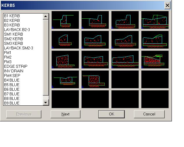

BIGAL Posted October 17, 2012 Share Posted October 17, 2012 Old fashioned way allows for customisation of the image started about 20 years ago I still prefer. This works via menu let me know if want example. Quote Link to comment Share on other sites More sharing options...
ReMark Posted October 17, 2012 Share Posted October 17, 2012 And the new way is drag...drop...done. Unless the OP is carrying some customization over from twenty years ago I'd say it was time to update his approach and utilize Tool Palettes. Quote Link to comment Share on other sites More sharing options...
