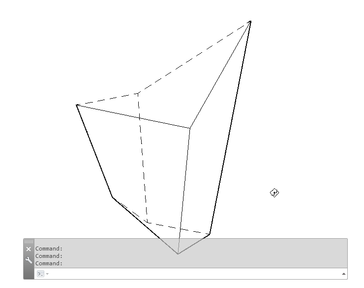

Multiple Points -> add z-value as label
careca
Hi all.
I have found this script by Lee Mac, which adds x/y coordinates to a selection of points.
I wonder what needs to be done to display the z-value of the points only. Though I had a try, I have not yet managed to understand this mapcar-thing.
Probably an easy thing to update the script below, any hints would be highly appreciated.
Thanks in advance.

If I were to rewrite the function today, I'd probably use something like:
(defun c:zpt ( / i p s )
   (if (setq s (ssget '((0 . "POINT"))))
       (repeat (setq i (sslength s))
           (setq p (assoc 10 (entget (ssname s (setq i (1- i))))))
           (entmake
               (list
                  '(000 . "MTEXT")
                  '(100 . "AcDbEntity")
                  '(100 . "AcDbMText")
                   (cons 1 (strcat "Z = " (rtos (cadddr p))))
                   p

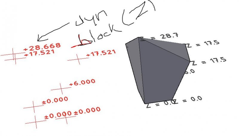

Very nice, but i have one other question too :
I wish to place a specified block (with Z automatic attribute) on every selected blocks in my drawing, how can i do that ? I try to change your code, but...
And i have to do that with a separated block (with specified name), not with the attributes of all my blocks, so i can change all "texts" in one step
Z auto.dwgIt can be, but i have some error messages when i try to execute your lisp (DNH command ?), old version for autocad for you (2015 C3D for me) ?
I just want to put the blocks (just one of the two blocks) on every selected blocks in my drawing, if i can replace it in your lisp ... :)
Maybe this explanes the use.

Why don't you use a field in a dynamic block to read the Z-value?
dyn-xyz as example
dyn-xyz-file.dwg
Ok, but i have many colleagues, i can't do this on every computers when a problem appears... Thanks for your help, but can i just use my block in any random dwg ? Can i change your code for this ? Thanks again
My block use a field, in a dynamic block, and in one block so i can change everything in just some clics. I have to many blocks to use fields in erevy...
You can make it stable and robust to work in your office environments. Make it a .vlx to make it non-readable and easier to load and revise.
You need to have a global (support) library for more reasons, don't you think?
My block "Z" use a field, in a dynamic block, with just one Z possibility, and in one block so i can change everything in just some clics. I have to many blocks to use fields in everyone... So i have to :
- Select blocks i want to label
- Launch the macro/lisp/vlx...
- Every selected block take the "Z" block for label, inserted on every block insertion point.
Thanks for your help, and sorry for my translations ;)
