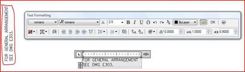

Casio47 Posted October 23, 2012 Share Posted October 23, 2012 Hello All.When I go into Multiline Text edit, the edit box is vertical instead of horizontal. So, i must edit in a vertical fashion. Upon completion, the text remains vertical and I must take the time to rotate it to horizontal. I do have WYSIWYG checked, but it still goes vertical if it's not checked. Also, it starts out (before editing) horizontal. The font is Ariel. AutoCAD 2010.Thanks for the help Quote Link to comment Share on other sites More sharing options...

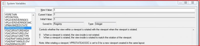

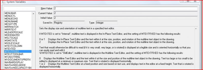

Dadgad Posted October 24, 2012 Share Posted October 24, 2012 Consider the system variable options shown in the image, and their descriptions. I believe you want your MTEXTFIXED variable set to 2. It sounds like you may have a rotated viewport, which is causing your issue. Quote Link to comment Share on other sites More sharing options...
Casio47 Posted October 24, 2012 Author Share Posted October 24, 2012 Consider the system variable options shown in the image, and their descriptions. I believe you want your MTEXTFIXED variable set to 2.It sounds like you may have a rotated viewport, which is causing your issue. How did you get the system variables window to appear? The SETVAR command isnt getting that window? Thanks Quote Link to comment Share on other sites More sharing options...
ReMark Posted October 24, 2012 Share Posted October 24, 2012 You can type SYSVDLG at the command line and it should come up IF Express Tools has been loaded. Quote Link to comment Share on other sites More sharing options...
