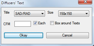

Is it possible to set_tile to 1 when a user type any char or number in the edit_box in the same DCL file ?

I am looking forward to check the toggle (Each) on when a user start typing in the edit box
[ATTACH=CONFIG]38220[/ATTACH]

to check toggle you need to tap TAB or ENTER first when leaving edit_box. there is no way to "dynamically" check what is entered in edit_box.

The $reason variable will hold a value of 1 if the user 'submits' the contents of the edit_box tile (i.e. by pressing Enter whilst the edit_box has focus), and will have a value of 2 if the edit_box loses focus without the user submitting the contents (i.e. if another tile takes focus). This behaviour was demonstrated by my example program in the post to which I linked, accompanied by a brief explanation of the callback $reason values.
