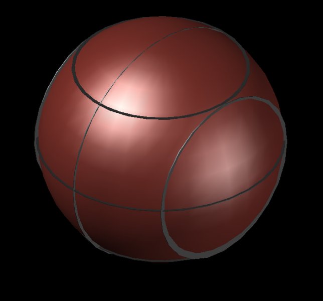

PotGuy Posted November 1, 2012 Author Posted November 1, 2012 Thanks ReMark. Currently, just made a basket ball using 3D. Quote
ReMark Posted November 1, 2012 Posted November 1, 2012 Did you include the pebbling (small bumps on the surface of the ball)? And don't forget the channels. Quote
PotGuy Posted November 1, 2012 Author Posted November 1, 2012 No, and yes...? What's the process for Pebbling..and are channels the lines that run around the circumference of the B? If so, I think I improvised! (Used V. thin Cylinders, matched the diameter of BB with Cyclinder and extended thurther out so it pokes out of ball; repeat to and bottom of BB, then rotate middle, repeat.) Quote
ReMark Posted November 1, 2012 Posted November 1, 2012 I think attaching a material would be the wisest thing to do if one wanted to model pebbling. Yes, the channels are the groves. Quote
PotGuy Posted November 1, 2012 Author Posted November 1, 2012 So, how would I go about attaching a material to a rounded...or flat surface? I know there's going to be a MUCH easier way than what I'm 'bout to say, but because my BB is only 1mm in diameter (Ant sized!)then could I just array 0.0(0)1mm sphere's around the BB using a Polar array? maybe 0.1mm increments? EDIT: Scratch that, used materials to emulate a BB material. Still, how can I create a 'rough' texture to it? Quote

PotGuy Posted November 1, 2012 Author Posted November 1, 2012 The computer good, thanfully! I'm in Temp. Works, but it's good to have practise in 3D as people do call for it occasionaly. Cheers for all the help! EDIT: When it's completed eventually, would anyone be interested in seeing what it looks like...maybe with it taking up less of the screen? Quote

PotGuy Posted November 1, 2012 Author Posted November 1, 2012 (edited) Sorry for double post, but the BB is up on Showcase! As mentioned on there, all feedback is greatly appreciated! Edited November 6, 2012 by PotGuy Quote
