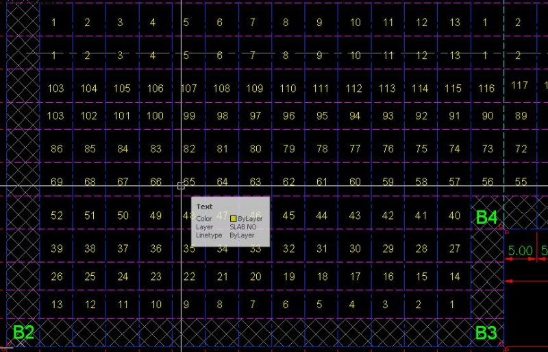

afrazawan Posted November 5, 2012 Posted November 5, 2012 i have a more then 9000 block in my drawing its a Apron Pavement by slab so i need each slab one Number starting from 1 kindly give me any lisp for auto numbering i ca'nt edit it manually each number thanks my numbering starting from right hand bottom ending top left Quote

afrazawan Posted November 6, 2012 Author Posted November 6, 2012 this is a image clear scale but this is more then 10000 block same like this its concrete slab i want to give slab numbering plz but Quote

ReMark Posted November 6, 2012 Posted November 6, 2012 Lee Mac's program that automatically labels attributes assumes you are using a block with an attribute. So the simple question is, Are you using an attributed block to create your concrete slab? Yes or No? If the answer is 'No' then you would be better off using Lee's Incremental Numbering Suite program which can be found here...http://www.lee-mac.com/numinc.html Quote
Lee Mac Posted November 6, 2012 Posted November 6, 2012 Cheers guys for the recommendations This may also help: http://lee-mac.com/incrementalarray.html Quote
