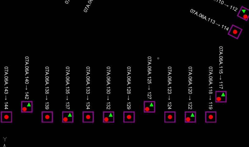

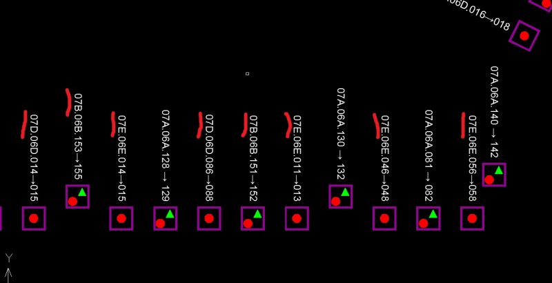

I'm sorry Lee but is a serious problem:
You can see on the first drawing all text begin with 07A...
After the lisp there are text with 07A, 07B, 07C,...
And all the numbers are foul.
I think make a mix of the text that he find in the drawing?!
So he don't take the right text to the right box.
Any idea?
The program simply uses the nearest text object to the insertion point of the block, that is all.

If you check the original plan on post#16...insertion point are always on the block and he don't take the nearest text.
The program measures the distance from the block insertion point to the text insertion point (lower-left corner), and uses the text with the minimum of these distances.
