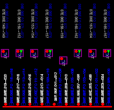

I believe you are experiencing problems because there are groups of Text objects in your drawing with no attributed blocks associated, however, such Text objects are closer to other attributed blocks associated with other Text objects, for example:
Here, the Text objects in the lower half of the image have no attributed blocks associated with them, however they are closer to some of the blocks in the middle of the image.

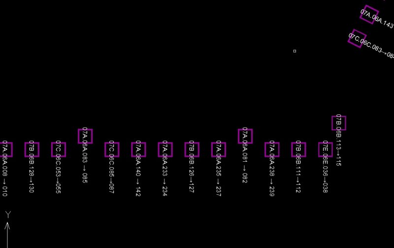

I'll will isolante all block 'Chapelle' on a new dwg and than lisp.
I'll make this test tomorrow and will give feedback.
After isolating all blocks "chapelle"...
There are always problem with numbers...
This is right back side of the plan view, and i have numbers 07B, 07C en 07D...normally only 07A.
He takes numbers from other side of the plan??
I'm really sorry about the result.
