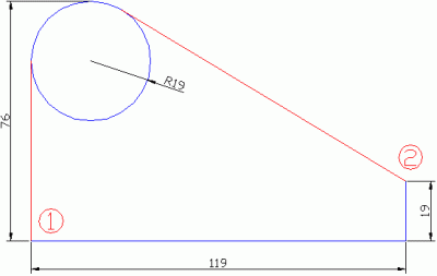

RoseMari Posted November 15, 2012 Posted November 15, 2012 hi, it's my 1st thread here, and hope you can help me with this issue The problem is about drawing a solid model like the one in the attachment, and I have problem with the triangle, I tried a lot of things, but unfortunately it's not the same as it should be you can see my work in the attachment, so please help me with it by explaining my mistakes. and one more thing, as it's my first time with these kind of drawing I need to know what's the meaning (10 Drill, 20 C'bore) for a circle and how I can do it you can find it in the attachment and sorry for bothering have a nice day my work.zip Quote
MSasu Posted November 15, 2012 Posted November 15, 2012 Please check the sketch below - the parts in blue can be easily draw, next just do two lines from points (1) and (2) using the Tangent Osnap mode. Trim the unwanted parts and call PEDIT to create a closed contour. Apply PRESSPULL or EXTRUDE command on that shape. Quote

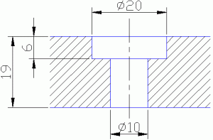

MSasu Posted November 15, 2012 Posted November 15, 2012 I need to know what's the meaning (10 Drill, 20 C'bore) for a circle and how I can do it I believe that this is what you need to model there: Just draw on top plan two cylinders (CYLINDER command) or alternatively two circles and apply PRESSPULL or EXTRUDE on them. Call SUBTRACT next to extract them from main part and therefore get the holes. Quote

tomhamlet Posted November 15, 2012 Posted November 15, 2012 hi, it's my 1st thread here, and hope you can help me with this issue The problem is about drawing a solid model like the one in the attachment, and I have problem with the triangle, I tried a lot of things, but unfortunately it's not the same as it should be you can see my work in the attachment, so please help me with it by explaining my mistakes. and one more thing, as it's my first time with these kind of drawing I need to know what's the meaning (10 Drill, 20 C'bore) for a circle and how I can do it you can find it in the attachment and sorry for bothering have a nice day I did this same drawing in college. The book, at least in my case, assumes you already know what is meant by c'bore. Any time you see "c'bore" it is usually refering to the bigger of the holes, and should be accompanied by another measurement defining the depth. in this case, 6. Quote
RoseMari Posted November 15, 2012 Author Posted November 15, 2012 I did this same drawing in college. The book, at least in my case, assumes you already know what is meant by c'bore. Any time you see "c'bore" it is usually refering to the bigger of the holes, and should be accompanied by another measurement defining the depth. in this case, 6. I don't have the book because the Dr. don't want it he just explain some of technique with the engineers to us and gave us class works and home works that's all, but he didn't say anything about c'bore and drill Quote

MSasu Posted November 15, 2012 Posted November 15, 2012 Seems that the slope line isn't tangent to the circle. Also, how much did you extruded the back part (sketch from post #2) - 10 or 19 units? Quote
ReMark Posted November 15, 2012 Posted November 15, 2012 C'bore = Counterbore. It's a term used in machining. How did I do it? Unfortunately I'm not at my CAD computer and won't be for a while. Everyone has their own way of creating the necessary geometry so my method may be different from yours. The more one is familiar with the commands at their disposal the more efficient they can be. Quote
ReMark Posted November 15, 2012 Posted November 15, 2012 Re: Your 3D model. What exactly did you subtract? What did you subtract it from? It looks like you mis-judged the extent of the triangular section. The sloped line should have been tangent to the semi-circular top. Quote
RoseMari Posted November 15, 2012 Author Posted November 15, 2012 that's what I get finally please tell me it's right and there is no mistakes Quote
RoseMari Posted November 15, 2012 Author Posted November 15, 2012 Re: Your 3D model. The sloped line should have been tangent to the semi-circular top. that's it , it's my mistake , I didn't know which point on circle should the line touch thank you Quote
