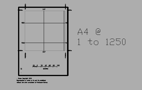

eldon Posted November 19, 2012 Posted November 19, 2012 When I get an electronic snippet of Ordnance Survey data, it comes as a DXF file. It is unitless, but Measurement is set to 0, so it picks up the acad.lin linetypes. The units are metres, and the detail is drawn to the Ordnance Survey coordinates, which are metres. You just get to know these things and deal with them. Unfortunately, even if I start a drawing with a metric template, the plot scales are full of Imperial (certainly for my version of AutoCAD), so one has to input useful scales. Usually I have found that the planning process needs a 1 to 1250 and a 1 to 500 plot. If using paper space, and set up with an A4 sheet in portrait mode, then the custom scales needed to plot the OS drawing are 0.8 for 1 to 1250 and 2.0 for 1 to 500. These scales are derived from the formula:- Drawing units (in millimetres) divided by drawing scale equals custom scale. For the 1 to 1250, we have 1000 divided by 1250 equals 0.8. Quote

eldon Posted November 19, 2012 Posted November 19, 2012 As you mentioned Layouts in your first post, I was assuming that you would be plotting from paper space, and of course the best way is to plot at 1 to 1. It is the scaling of the viewports that needs to be attended to, and my remarks on scaling should have mentioned viewports. I am most surprised that you should feel the need to go to a scale of 1 to 1500, when I can manage to get a whole 40 hectare picture onto a 1 to 1250 with lots of room to spare. Whatever you do, put a North point on your plot and also a scale bar. Quote
