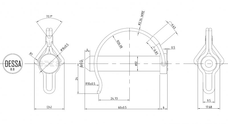

I have created the attached part using AutoCad both 2D and 3D.
I am now trying to use Inventor and have really struggled, I have completed the tutorials shipped with the program and have managed to create the pin body as attached (using a revolved sketch), but in doing so have a few questions.
1. How to use hole function to create the 3mm dia hole on the pin head, as it does not seem to like curved surfaces? (To achieve I extruded another solid and subtracted just like Acad)

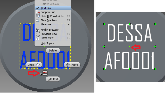

2. How to align the emossed text exactly centrally, I have just eyed it in as constraint did not work.
3. How to find out the weight.
4. Is it possible to model the spring wire and clasp in Inventor? I have tried using a 3D sketch but there do not seem to be enough drawing tools (ie circle does not exist) to achieve this shape, also there do not seem to be snaps and grips etc. Do I have to do this in Acad and import?
5. How can I see my original sketch? It does not show up when I select edit or slice.

2/I middle and centre justified the text, but again the justification point did not appear for me to 'drag'. Are you suggesting I add a dimension to the text (height or width or diagonal?) or from the text to the object? Where would one add the constraint? I followed the glass bottle tutorial but this only helps with alignment in one direction, I tried to add a vertical constraint but received the message '...over constrained'.
Turn off the text box and you'll get your point.

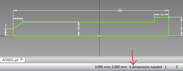

Your Sketch1 is not constrained.
Worry about this now, and later on you won't have to because Inventor will be creating all these constraints for you.

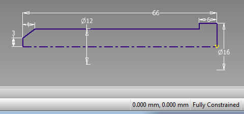

Now you didn't really need 4 dimensions, but use the BORN Technique and also leave 45° chamfers and fillets out of sketches - add them as features.
First add a horizontal or vertical dimension to the text box as appropriate.
then
right mouse button turn the box off and you will see a centerpoint grip that you can dimension or constrain
but
I usually just add a dimension to the text box (size doesn't matter) and then sketch a diagonal construction line to use the midpoint for constraining.
This is how I'd do it.

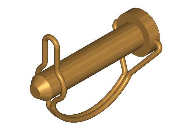

Very nice work!
Just add a cut in the ends where they go into the hole in the pin.
Noticed a bit more missing - but your file should give the OP a good idea how to continue.

Very nice work!
Thanks. I wasn't going for exact accuracy from the drawing, just a basic idea of how to do it. To be honest, I didn't even look at the drawing - just the 3D model from the OP.

Thanks for text box tip, I have managed to complete this now. Regarding the 2D sketch why does specifying dia12 and dia16 provide anymore constraint than detailing 6 and 8 resp half sizes?

I used 3 2D sketches to create the sweep path, plus a 4th to provide the circle that I swept around the path.
What is the purpose of the 3D sketch option? First appearances would suggest this is a true 3D problem.
It is a 3D problem ... but sometimes the quickest way to create 3D stuff is to start from 2D references.
In the sample I uploaded, Sketch 1 creates the overall shape along the YZ plane. Sketches 2 and 3 are projected onto that shape in the positive and negative Z directions, respectively. The 3D sketch is created by projecting the intersections of Sketch 1 with Sketches 2 and 3. This gives us our 3D profile to follow.
Not sure that it does. I think it might be just a style thing as much as anything. What JD did there was set the one edge as a centerline, and then when he dimensioned from it to the outside, Inventor assumed that it was a diameter, to be symmetrical across the centerline. I've never actually done that before, myself, but there's a reason why he's a professor and not me. To be perfectly honest, I didn't even know that would happen! :oops:
