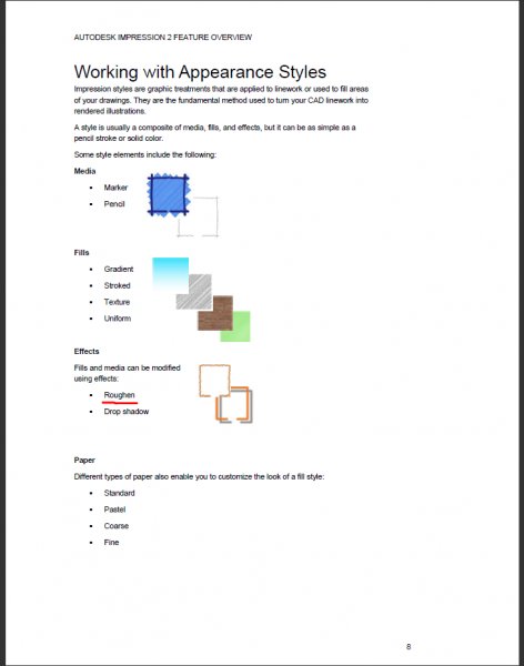

Anyhow, if you've got a subscription, then you can download and install Impression for free. That would give you a lot more than the lisp could ever achieve.

Not up for trying Impressions then?
