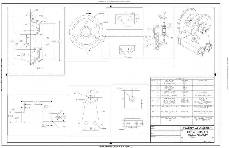

sean214 Posted December 5, 2012 Posted December 5, 2012 instructions http://www.mediafire.com/view/?l6xdfm6rtclo1t4 dwg attached Okay I know the measurements are a hard to see in the pdf but do my isometric drawings look correct? many thanks project241.dwg Quote
Ajcraig99 Posted December 5, 2012 Posted December 5, 2012 You need hidden lines, center lines and consistency in your outlines, you have used 3 different layers for outlines. The iso looks correct but could be some technicalities that i have not noticed (im no expert). Your lines also dont need to be so thick, set them to default. Quote
rkent Posted December 5, 2012 Posted December 5, 2012 The left most drawing you have several lines that are supposed to be at 0 or 90 degrees but instead are off slightly, be sure to use Polar or Ortho when drawing those lines. You need some center lines. The iso looks good, you can copy the large circle back and trim most of it away because you would see the back part of that large circle. The bottom line on the front view is made of two lines, don't do that, it should be one line. The next one you left out hidden lines in the top view, front view and right side view. Center lines needed for ortho views. The third from the left you can copy the iso circles back and trim to show thickness. Center lines needed on ortho views. Quote

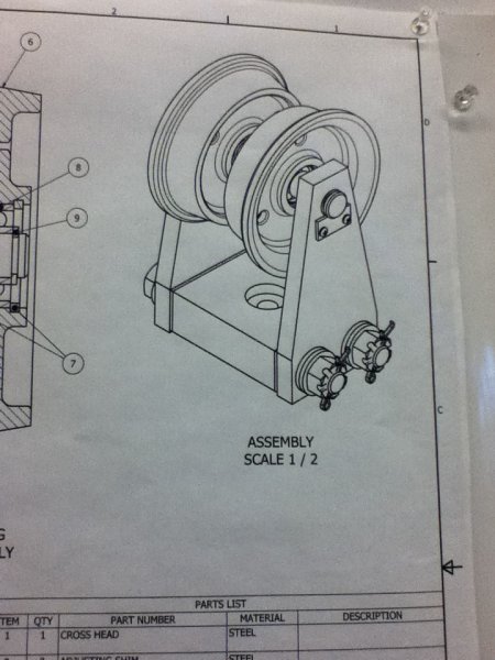

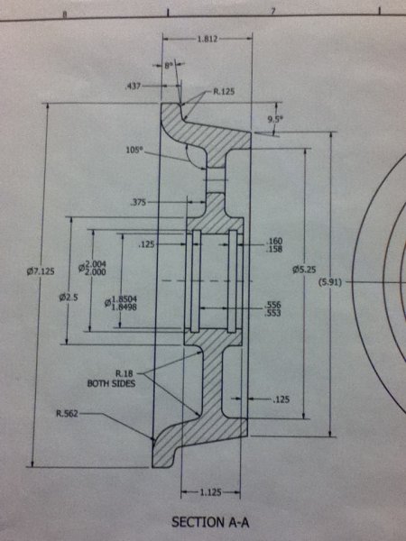

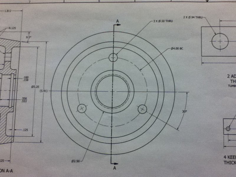

sean214 Posted December 8, 2012 Author Posted December 8, 2012 i cannot draw the wheel i tried all day Quote
ReMark Posted December 8, 2012 Posted December 8, 2012 And what exactly seems to be the problem? Do you have all the required dimensions to create the profile (first image)? How far have you gotten? Quote
JD Mather Posted December 8, 2012 Posted December 8, 2012 i cannot draw the wheel i tried all day 2D or 3D? Attach the dwg file of what you have attempted here. Quote
sean214 Posted December 9, 2012 Author Posted December 9, 2012 okay i attached the file and now i need help completing it and assembling 2D or 3D?Attach the dwg file of what you have attempted here. big paper two.dwg Quote
sean214 Posted December 9, 2012 Author Posted December 9, 2012 The problem is that I m having a hard time visualizing the isometric and the side view fillets aren't measuring up with the outer isometric of the wheel. Quote
