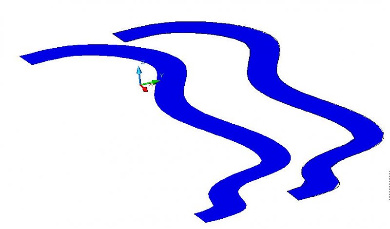

from the looks of it you have your yellow lines as the edge of the track and the dark line the center? You can draw a cross section of the road(rectangle) and sweep it along your path. I cant remember if you can use two guides or not, if not you may have to play with twist and some setting. if that doesnt work for you , you do have a few options.
First thing i would try is breaking up your track into 4 sections and use the edgesurf command with surftab1 and 2 turned up to retain your curves. You can do this is more than 4 sections.

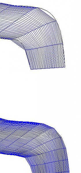

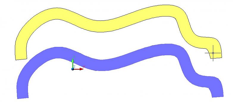

Here are two quick files i made. Its a spline path inside and out and two straight lines connecting it. The first(top one) i had surftab turned to 35. you can see it had trouble with the curve. 35 means for the total shape there will be 35(surftab1) in the x direction and 35(surftab2) in the y direction(these arent actually x and y but in relation to your curves, typically called M and N). So you can see altering these numbers will make a difference. Since your path is relatively thin compared to lenth, these numbers can be wildly different. In the third drawing the yellow track i have surftab1 = 100 and surftab2 = 10. so 10 segments or cells for the width of the track and 100 for the length. You can also see that if you break up your track into multiple sections you can define smaller "cells".
If you plan to do the whole track in say 2 sections you will need to turn surftab1 way up.

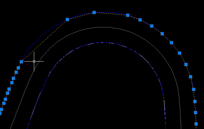

First of all I would clean up the poly as it doesn't even match the curve. I would not even consider edgsurf, surftab..... as suggested by shift, those are obsolete commands that are not useful in r2007 and later when there are much more powerful surface commands available.
