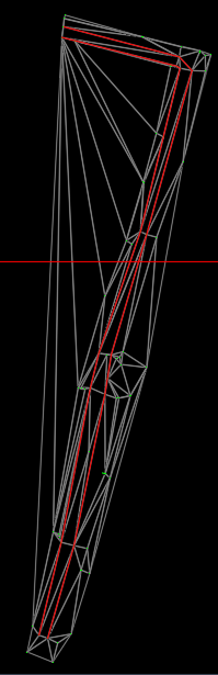

BIGAL Posted November 7, 2019 Share Posted November 7, 2019 (edited) The other option is to use a ssget to look for a "POINT" at the pline vertice much easier in particular OP wants to do multiple only problem may be if you are missing a point. Something like this p1 is pline vertice. (setq p2 (polar p1 (* pi 0.25) scalef)) (setq p3 (polar p1 (* pi 1.25) scalef)) (setq ss2 (ssget "CP" (list p2 p3)(list (cons 0 "Point")) )) Looking at your sample dwg what I have suggested with code would result in "You have a pline vertice with no corresponding point now exiting" How are you making the points in the 1st place from a csv ptnum,x,y,desc then there are better ways to do the line work from the point file. For fun triangulated with Civ3d Edited November 7, 2019 by BIGAL Quote Link to comment Share on other sites More sharing options...
