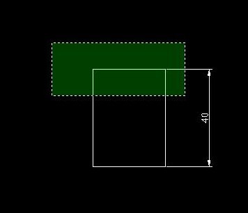

BIGMIKE09281946 Posted November 11, 2008 Share Posted November 11, 2008 I have a rectangle consisting of four individual lines. The rectangle is (x) units wide by (y) units high. How can I get the (y) dimension to associate with the (x) line; so that the (y) dimension scales to the vertical movement of the horizontal line. I have removed one of the (y) lines, and dimensioned to the (x) lines; replaced the (y) line; and re-associated the dimensions to no avail. Quote Link to comment Share on other sites More sharing options...
soleary Posted November 11, 2008 Share Posted November 11, 2008 I have a rectangle consisting of four individual lines. The rectangle is (x) units wide by (y) units high. How can I get the (y) dimension to associate with the (x) line; so that the (y) dimension scales to the vertical movement of the horizontal line. I have removed one of the (y) lines, and dimensioned to the (x) lines; replaced the (y) line; and re-associated the dimensions to no avail. Make sure DIMASSOC is set to 2. Dimension the vertical line. Use the stretch command making sure to use a window from the bottom right to the top left (green crossing window) as in the picture Quote Link to comment Share on other sites More sharing options...
BIGMIKE09281946 Posted November 11, 2008 Author Share Posted November 11, 2008 Doesn't work! By the numbers, as per G.Omura Maste..2k8: 1. Click the Stretch tool in the Modify toolbar, or type S [ENTER] and then C [ENTER]. 2. Pick a crossing window, and then press [ENTER] to confirm your selection. 3. At the Specify base point or displacement : prompt, pick any point on the screen. 4. At the Specify second point or : prompt, enter @2' Quote Link to comment Share on other sites More sharing options...
soleary Posted November 12, 2008 Share Posted November 12, 2008 Doesn't work! By the numbers, as per G.Omura Maste..2k8:1. Click the Stretch tool in the Modify toolbar, or type S [ENTER] and then C [ENTER]. 2. Pick a crossing window, and then press [ENTER] to confirm your selection. 3. At the Specify base point or displacement : prompt, pick any point on the screen. 4. At the Specify second point or : prompt, enter @2'Works for me BIGMIKE. (Assuming that I understand what you want to achieve). In my example, you want the vertical dimension to change value when the top horizontal line is moved. Is that it? Why not post the drawing? Quote Link to comment Share on other sites More sharing options...
