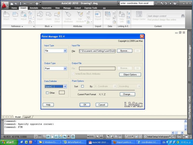

Dear Lee
I have downloaded your LISP for importing xyz coordinates from a text file into AUTOCAD to draw lines. Thanks for writing valuable LISPS.
The LISP loaded successfully.
After importing the file, following error message appeared:
** Error: Upper bound in SAFEARRAYBOUND occurred to be less than lower. **
I can't understand what it is talking about and how can I solve it.
Any help is highly appreciated.
I don't know if it is correct that OutPut File box is grayed out or not.
I have to add that my data format is as follows:
Point No. x y z
1 0 0 0
2 0 0 2
So I think it should be in x y z format.
Is it possible to include the point number in the input file?
BR
Khoshravan
Edited by khoshravan
Hi khoshravan,
Your data will need to be in the following format for use with my Point Manager program:
x y z
0 0 0
0 0 2
Of course, a custom program could easily be written to process any format of data, however, my Point Manager program was originally written to be as generic as possible to benefit the most number of users.
Lee
